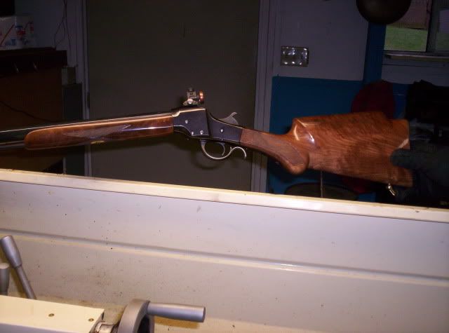

they are not strong enough for modern rounds. did this one several years ago for my brother, green mountain 54 cal barrel cut the breach plug to take a 209 shotshell primer, makes a really neat muzzle loader. he's taken a bunch of deer with it.- marlinman93
