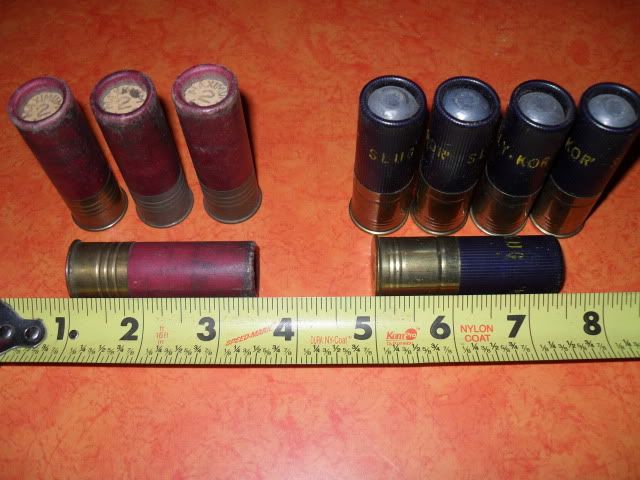

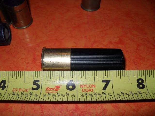

I found the paper shells on the left that are number 2`s max load, they measure 2 7/16 over all length. The slugs to the right of them measure the same.
The two on the far right are modern shells that are marked 2 3/4 but measure 2 1/2.
I`m not up on all these shotgun shells, can i shoot the number 2`s in my Browning A5 that has a 2 3/4 chamber?
Was thinking they would make a good home defense load.
How do they measure shells, fired length ?
Thanks

Fired length Pithchy. 23/4" should be that once fired.
N.
Re: Need shotgun shell help
But they are longer, are they 3 inch shells, they fit in the chamber fine. See how much paper is above the wad where it says 2.
My main question is are all those shells considered 2 3/4 shells even though they vary in length.

Shotshells are always measured in the fired condition. Those slugs bring back old memories. They are poly core Imperial slugs made by CIL just down the road from me in Brownsburg Quebec. They have a regular hollw base foster type slug with a plastic core that brought the sides of the slug back to their original shape once they went through a tight choked barrel.

By the time those roll crimp unroll, I am willing to bet they will measure 2 3/4". If you are worried that they are too long for your auto 5 , borrow a friends 3" shotgun and fire 1 of each off and measure. I am willing to bet they will measure 2 3/4" long once fired. Some roll crimps suck up more material to complete the crimp than others.

If memory serves me right------------------------------
The older paper 12 gauge shells were available in 2 5/8, 2 3/4, 2 7/8, 3, and 3 1/4 inch lengths. In addition, 12 gauge brass shells were also offered in a 2 1/2 inch length. The longer shells were usually for more and better wadding, not a heavier shot load.

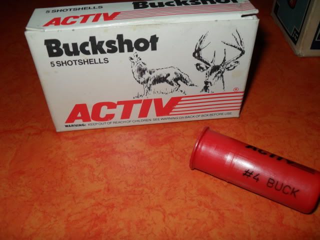

Trying to figure out what to keep the old girl loaded with for HD, the only buck shot i have is some all plastic case stuff that sometimes don`t eject because the rim isn`t as big.

No. 12
If A Three-inch Shell Fits In My Gun's 2 3/4-Inch Chamber, Can I Fire It Safely With The Longer Shells?
The barrel of my 12-gauge shotgun is marked for 2 3/4-inch shells only, yet a three-inch shell will easily slip into its chamber. Does this mean it is safe to shoot three-inch shells in my gun?
Absolutely not. The linear dimension used to identify a particular shotshell refers to the length of its fired case and not that of the loaded round. Actual length will vary slightly among various brands of shells, but those designated as 2 3/4 inches usually measure around 2 5/16 inches before firing and 2 5/8 to
2 11/16 inches after firing. Three-inch shells usually measure from 2 1/2 to 2 5/8 inches before firing and lengthen to just under three inches when fired. Since the 2 3/4-inch chamber of a shotgun will usually measure at least that long, and sometimes slightly longer, you can see how an unfired three-inch shell will drop right into it. Firing shells of excessive length for the chamber can generate dangerously high pressures for the following reason: The inside diameter of a shotgun barrel rapidly becomes smaller just forward of the front end of the chamber in an area called the forcing cone. When a three-inch shell is fired in a 2 3/4-inch chamber, its crimp section opens into the forcing cone and in doing so effectively reduces bore diameter at that point. If the shot charge and wad column are required to squeeze through this partial obstruction, chamber pressure can increase.

Different brands of plastic shells have slightly different rim sizes. You can just buy a box each of several brands of 7.5's and test drive them. I would do it at a trap or skeet range, it's more fun that way.

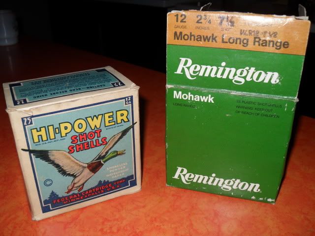

Found this older box in the shed today also, on the left, and the Rem 7 1/2 are what i have in the A5 at the moment.
I`ll have to see where number 2`s are available next time i`m in the big city.
This is the buckshot that doesn`t work in the A5 very well, works fine in the Mossy 590.

Here`s the answer to my question, i took them apart to compare.
The 2`s are 2 3/4 shells.

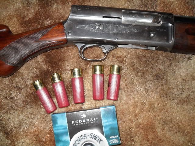

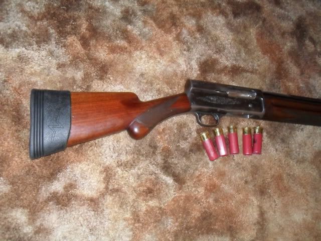

This is what i got today, Fleet Farm had 4 buck for 4.29 a box so that`s what i got, i like the idea of having a few more pellets even though it doesn`t penitrate quite as good as 00 buck.
Also got a small slip on Limbsaver that fit perfect on the shortened stock.
