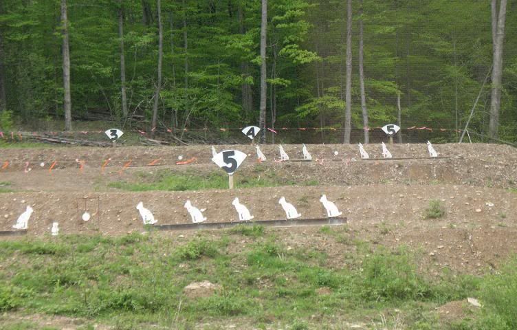

TARGETS....
The steel javelina targets are in the second group out. They stand 300 meters (327 yards) distant from the muzzle. They are 9" high x 22" long.....a bit thin on elevation but good on windage.
close up….

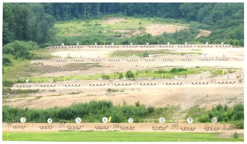

What are the targets 'way out there' past the first four rows, up on another hillside...?

The large white target with a black circle is the steel buffalo. It's at 1000 yards but from a slightly different firing line than John was shooting from. At the closer firing line I believe it's 950 yards. I'm not sure what the others are as I haven't been to Ridgway for some time. There used to be a variety of other targets including bowling pins and bowling balls from about 700 yards out to the buffalo, many intended for scope shooters.

Cimmaron Red,
Thank you for answering the question. That pic was taken at the 2008 Nationals, since then they have added long range targets and are having long range benchrest silhouette matches..... 10 shots at each distance.
850 yards - crows
900 yards - woodchucks
950 yards - bobcats
1000 yards - coyotes howling
Current record is 34x40 that was just set the last match of this year.
Match results can be seen at the club website http://www.ridgwayrifleclub.com

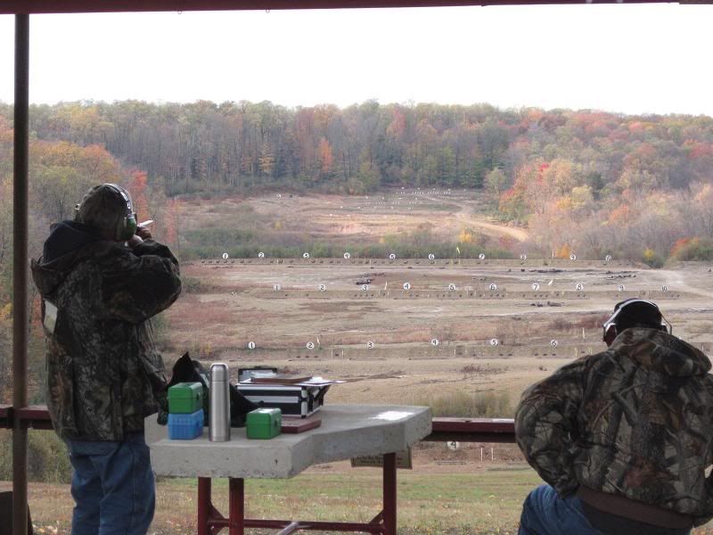

Here's a pic I took at the jubilee a few weeks ago that shows the added long range course.
Steve was shooting at the 900 yard bobcats offhand just for the fun of it and after several shots actually knocked one down using his 30-30 and a 180 gr cast bullet! :D
a closeup of the 950 & 1000 yard targets

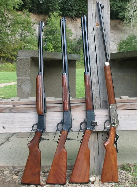

Fellow levergun enthusiasts,
Thank you for the kind words. The rifle I used is a Marlin Cowboy Ltd 44-40 (3rd rifle from the left).
Normally, I use the receiver sight at 300 meters, and in good lighting conditions, the javelina pretty much don't stand a chance when shot from a rest, but on this occasion, though, I had a 4X scope mounted for the purpose of testing a new black powder bullet that I had designed to run for many shots with any black powder in a repeating rifle. Accurate Molds made the 43-215C mold which is shown next to the 427098 which works great with Swiss for many shots in a repeating rifle, but not with other b.p.'s (Goex, Schuetzen, Diamondback) which will "foul out" (hard ring of fouling extending from the muzzle back into the barrel)in less than 15 rounds, with accuracy going downhill after that.
Previously, testing of the 43-215C out to 200 yards indicated that it runs well for 50+ shots with Goex with good accuracy. It did well at 300 meters on the javelina swingers and seemed to shoot almost as well as the 427098 / Swiss combination. I was out of cartrdges loaded with the 43-215C / Goex when I decided to try the javelina with the remaining 427098 / Swiss cartridges I had left.
