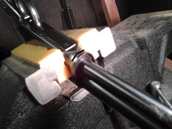

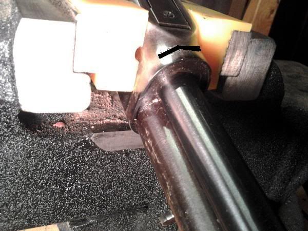

First ! "WELCOME" I've heard of some cases where the tube is soldered in. Can U c any solder residue. I hope not but if that is the case -laeve it alone. They r only inserted about a 1/8 to 1/4 inch so should be fairly easy to wiggle loose side to side. I think Pictures would really help diagnose Ur problem.

I will go the route that Joe suggested above. Perry, I do not see any solder residue, though there are some hints of rust. I added some pictures.

AH, I c UR prob. That notch in the bottom of Ur recvr prolly has a key in it to hold the mag tube in place. "C" THE pics helped.

Well, with my confidence restored by the good people on here that it *should* come out, I put the mag tube into the padded vice jaws, tightened it down as much as I dared, and used the receiver as my enhanced grip for wiggling and pulling.
After about a minute of wiggling back and forth and pulling, I gave it a full weight pull and it finally came loose.
It doesn't look like the mag tube was dented by the vice jaws at all, so I am cautiously optimistic there. It looks like the culprit was some rust in the receiver hole for the mag tube.
