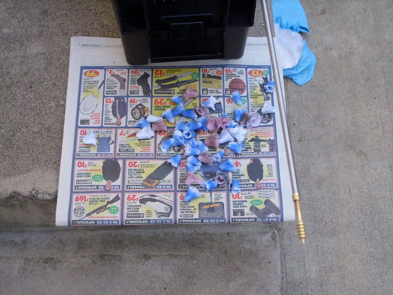

This was a half hour of Sweets (on jag) followed by Kroil.
I have gone thru this barrel (Marlin 1893 t/d 30 wcf) 3-4
times in the past or more. Used Butch's, Kroil and copper
wool with Kroil.

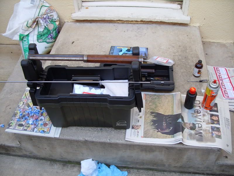

This is my setup with barrel moved to air the front notch,
Sweets was eating around the front sight. Always clean outside
and the side step seems the best for me.
I got the buggered screw out :D of the action.

I still have lots to do and will hit it with copper wool and Kroil next.
More than half way thru what I expect is 100 yrs of buildup.

bsaride,
It's a lot of work cleaning years and decades of fouling build up out of a rifle barrel. Been there, done that.
You mentioned using copper wool. Since the bullet fouling is copper, and you're using copper wool you might be getting a false blue from the copper wool. I've had that happen from brass and bronze brushes.
What I do now is use stainless brushes for a couple strokes, then let the chemicals do it. That way the only thing the chemicals are reacting to is the crud in the bore.

J Miller wrote:bsaride,
There is alot of lead fouling, that's why I'm using the copper wool.
Alternating from lead copper fouling techniques.

As long as you keep using that brass jag you are going to turn every patch you use blue with any copper solvent, no matter how clean the barrel is!
I use an Outers Foul Out--Gets out copper and lead. Plus it gets out corrosion which is great when messing with the old rifles with less than perfect rifling. When the "clean" light goes on, I know its clean.
Nice takedown Marlin you have there. There's a lot less Marlin takedowns than Winchesters. How does she shoot?---------------Sixgun

Sixgun wrote:Nice takedown Marlin you have there. There's a lot less Marlin takedowns than Winchesters. How does she shoot?---------------Sixgun
Don't know yet, got the last buggered screw out yesterday on the
disassembly and cleaning, I have several locking lugs to try when
I put it back together and check headspace. haven't taken the front
end apart yet either. unsure how critical a tight takedown latch needs
to be, but still need to address that as well. slowly getting it right and
worst case will shoot it at the socal reunion.
