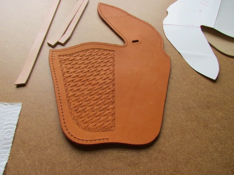

I even found time to do a little on Salvo`s holster project.
:D
Note: the holster is still a test pattern and we will be making changes I am sure.
Like the basket stamping leaves much to be desired. My first try don`t ya know?? :wink:

cant wait to see the finished holster too!
Re: Finally shot my .38-55 today.
Handsome looking shells and nice group, the basket weave looks good to me. 8)

Looks like you've got a shooter, Chuck. The basketweave looks good. I haven't done much myself, but I know I need to pickup a second stamp and grind off one side of it for the ends around the border. Trying to tip the stamp so it doesn't mark to much near the border just doens't cut it. For me at least.

kimwcook , I had planed to do just that with the basket stamp. I may get a couple extras and modify them so they work better in the corners and edges. :wink:
They probably will rust though after grinding through the plating. Unless they are chrome/Nickle stainless witch I doubt. Sometimes Tandy has them on special or even a coupon for a free stamp of your choice. :D

Nice looking leatherwork.
I would be interested in seeing that one as it progesses.
I have made quite a few sheaths and other things but not a holster yet and I need to make a few.
I agree. I desire it much!
