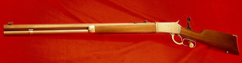

Even though I'm "a scope guy" when I hunt deer due to 'light gathering' of the 50mm+ objectives, for most other shooting I prefer a 'peep' sight.
On the Rossi, you can get a VERY accurate sighting setup with either a tang sight (the 24" octagonals are all I think already tapped for one, and the Taurus one fits and is a Marble's clone for $29, so it is the least expensive way to get a better-than-factory sight), or a Williams FP you can drill & tap for.
link to post on Rossi 24" tang/globe sight post - http://www.levergunscommunity.com/viewt ... =1&t=20359
link to Williams FP installation post - http://www.levergunscommunity.com/viewt ... =1&t=25689
link to lots of other sight pictures - http://www.levergunscommunity.com/viewt ... =1&t=31831
As far as finish - the octagonal one I got a couple years back is a 'matte' or brushed finish that almost looks 'pewter' in tone - very attractive, and not out of place on the older style gun like a shiny finish would be. You can kind of see the finish in the above 'tang sight' photos; the shiny finish is on a 20" .454 Rossi.
