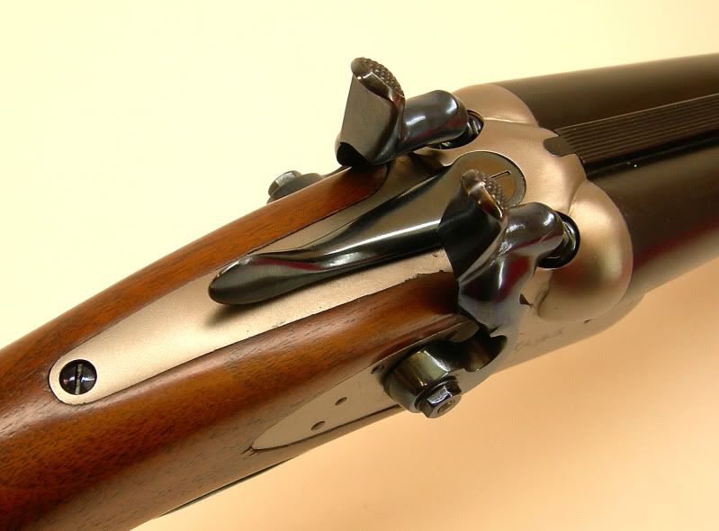

I don't card like that. I buff to a high polish, clean with lacquer thinner then dunk them to color. A little heads up. Remove them just a bit light in color because they will darken slightly more once oiled.

No, I buff, clean with the lacquer thinner then into the heat. You can actually get the same effect by buffing the screws and heating them with a torch. When you heat steel it changes colors. The problem is the torch doesn't work well with larger parts. The hot salt Nitre blue is just a way to control the heat.
To get the color you want it's a kinda trail and error process. The hammers and top lever for this one went a bit darker than I wanted. To correct to a lighter color requires repolishing. The trigger guard and fore-iron came out just about right.

Nate Kiowa Jones wrote: I don't card like that. I buff to a high polish, clean with lacquer thinner then dunk them to color.
I was under the impression carding was done to remove some (all?) of the initial salts. The vid didn't say WHY they were doing it, just that they were doing it. I presume the lacquer thinner evaporates before the part gets to the salt bath?
Nate Kiowa Jones wrote:The hammers and top lever for this one went a bit darker than I wanted. To correct to a lighter color requires repolishing.
Does the repolish take it back to bare metal or does the part get progressively lighter and you stop when you reach the color you wanted to begin with?

awp101 wrote:Thanks all! As usual, now I have questions about the answers... :lol:
Yes, I use the thinner because the polishing compounds have oils in them.
No, The polish takes it back to a bright polish. Then you start over, back in the heat.
