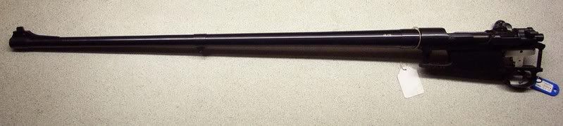

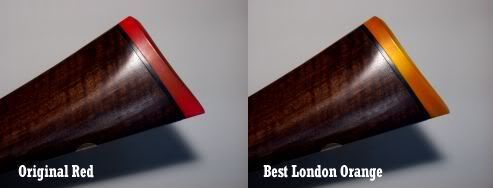

My .45-70 Siamese Mauser should arrive from over east this week and will then go off to have the stock built. I am thinking of having a recoil pad fitted from the outset. I like the look of these traditional English pads from S.W Silver but they are practically rock hard.
Any suggestions?

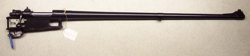

These are pics of the rifle from the gunsmith. Barrel length is 24". The banded ramp front sight and barrel band swivel stud are from NECG. Rear sight is an XS and will be fitted with a Merit adjustable aperture. Front sight is the NECG sourdough.

When I worked for Westley Richards they put similar pads on their double rifles and bolt actions. I always thought they were not so much a recoil pad more of a boxing glove! If you're on the wrong end of it it then it will hurt! Still I suppose they are softer than steel! :)
