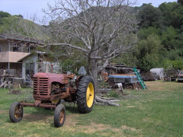

Is it a Massey like this Massey Harris 33?
If so, you need to check to see if it has juice to the coil and from there juice to the points. Then check the coil lead, distributor cap and so on as explained above.
