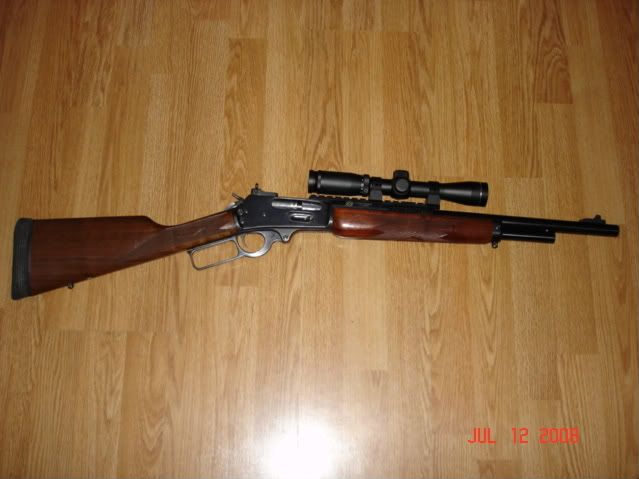

I have a inexpensive NC Star pistol scope on my guide gun. It's nothing fancy but has so far held up very well to full house 45-70 loads. The one I bought has the illuminated recital but that is pretty much useless in my opinion. If it will even last you a season or two it may be enough to get you by til you can afford something better.
Here's a link
http://www.opticsplanet.net/ncstar-illu ... pb273.html
Here it is on my guide gun.
Here's a link
Ricky
