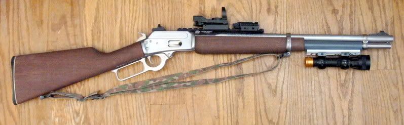

Posts: 34118
Re: Marlin 1894 breech bolt fit
I've had and handled 1894's of several vintages from 1970's to 2009, and the only one with much of a cosmetic issue was the 2009 1894CSS.
Here's my rant and pics of the 'flaws' in the new gun ---> http://www.levergunscommunity.com/viewt ... =1&t=20029
Still, it shoots fine - since it needed some cosmetic changes, in addition to the stock swap (see above thread), I chose it to make into one of my more useful, if 'nontraditional' guns.
I called the project my 'Night Scout' rifle ---> http://www.levergunscommunity.com/viewt ... =1&t=23531
It now sports a refinished stock and satin-brushed finish, plus the action slicked up as per articles on this forum.
SOME of the issue with mine was a VERY stiff extractor, which prevents FULL bolt closure unless a cartridge rim is under it, pushing it to the side enough to clear the beveled edge of the extractor cut in the barrel. That can be fixed, or will clear up with time, or can be ignored...
