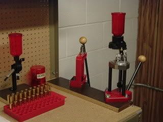

So, my press is like the single-stage you have there on the back right. Can I take it from your "+1" that you also support the Pro Disk dispenser for use with that press?Old Time Hunter wrote: +1

Yep you sure can, as long as you batch. My 2400 loads, even though there is a little spillage, generally stays +/- .05 grainsalnitak wrote:So, my press is like the single-stage you have there on the back right. Can I take it from your "+1" that you also support the Pro Disk dispenser for use with that press?Old Time Hunter wrote: +1
