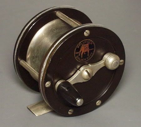

Right after I discovered the stuff, I was rebuilding a tired frozen Golden West, but first was trying to get it apart - the sideplate screws spun the nickel silver posts and wouldn't break even with a set of Big nylon tubing pliers holding the posts. So I sprayed the right areas with Boeshield to act like penetrating oil on the screws, and the next day, the whole reel was spinning like a top.
um, it didn't quite look like this before I worked on it (all the nickel silver was red with dealloying, the ebonite was tan with oxidation, and the aluminum was white with chalk)
the aluminum rings under the ebonite were corroded and swollen, and the Boeshield dehydrated them allowing the ebonite to relax, and little bit that seeped in internally softened all the waxed grease.
When grease breaks down, it makes wax and weak acids. All of that reacts with dirt to make a substance that is like hard clay. Boeshield removes the waters of hydration in the salts and the whole thing goes back to liquid.
If it's working for you then, you're really not done, but you know what the problem was - it still needs a disassembly cleaning.
