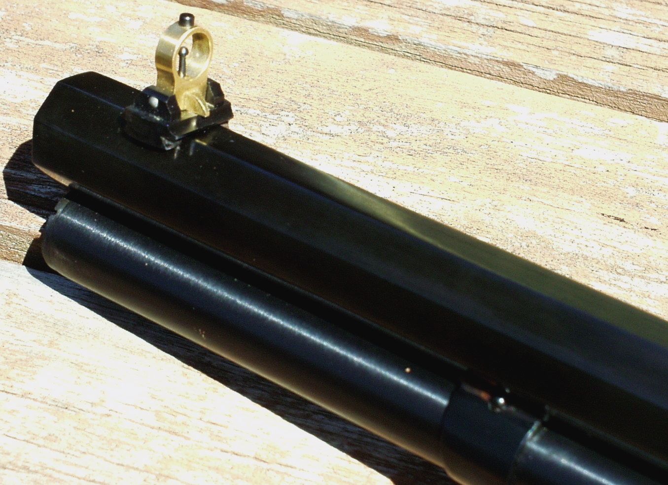

I finally got my Chaparral 1873 .357 to the range today.
Using a Uberti Beech sight up front and a Marble's tang sight. I replaced the rear buckhorns with a level.
Mechanism was a bugger since the extractor wouldn't pull the spent brass past halfway, and I had to do it all by hand, but aside from that...(caught my thumb in it once real good, but I kept the blood off the steel...)
after a bore sight, my first 100-yd shot was dead elevation and 5" right on the windage.
By the end of 50 rounds, I was grouping 3 inches and hit 3/4 diamonds on the last 4 shots.
I was shooting Ultramax 125-gr RNFP cowboy stuff (reported 850 fps out of a pistol and while I'm sure my 24" barrel was beating that velocity, it was all subsonic). Looking forward to making some loads now.
Planning to start with 130-gr. RNFP lead with 10 grains 4227, and ease up from there.
But yes, I was surprised and delighted with the result.
bdhold
Re: peep sight - oops?
Post by bdhold »
I need some overcast, but here's the basic setup

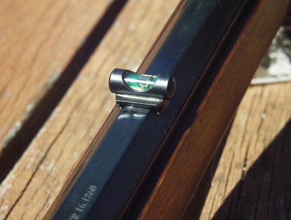

OH very nice. I really like that front sight.
bdhold
Post by bdhold »
thanks, as I said, I really like the level in place of the rear buckhorns - in fact, with the sights folded the level is actually easier for my tired eyes to shoot on the front blade than buckhorns would be.
pokey
Posts: 2704
Location: La center, wa.
Post by pokey »
nice job.
like the level.
"BECAUSE I CAN"
bdhold
Post by bdhold »
I guess if I push the distance out, it may actually matter, but what it really does is improve my concentration on the sight image. As I said, I was surprised and delighted with my groups.
futura
Posts: 27
Joined: Thu Jul 01, 2010 9:04 am
Location: Winnipeg, MB, Canada
Post by futura »
bulldog1935 wrote:thanks, as I said, I really like the level in place of the rear buckhorns - in fact, with the sights folded the level is actually easier for my tired eyes to shoot on the front blade than buckhorns would be.
Your gun is really coming together well. Good job.
Where did you get that level in place of the rear buckhorn? I search Brownells but had no luck.
