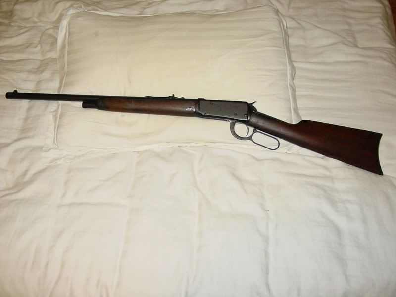

I got this gun back in 2005, when my uncle passed away. It was in really rough shape with quite a bit of pitting on the outside and the end of the barrel looked like it had been cut off with a bolt cutter. However, the inside of the barrel really didn't look bad. So I figured it might be worth saving as a shooter. There is a whole post somewhere with my adventures getting it straightened around so I won't go into that now. So, long story short, right before thanksgiving, I took it to the range with some rounds that I'd loaded up to see if it would shoot without blowing up. and it did. and pretty darn well.

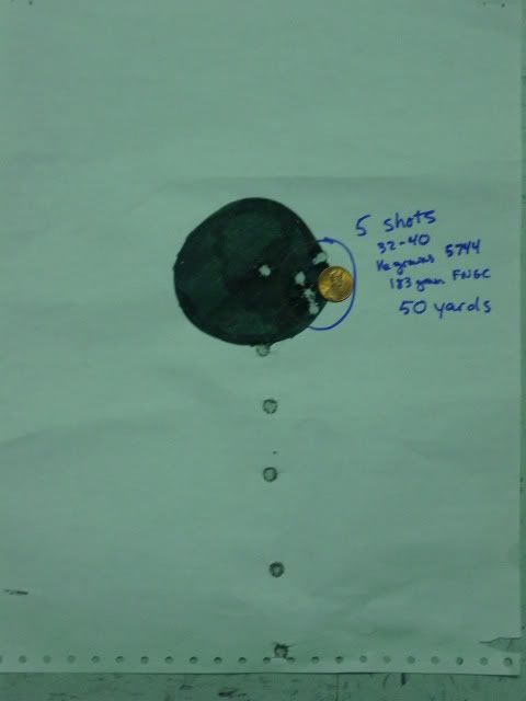

I didn't really shoot for groups that day as I was just seeing if the gun would shoot at all and if my loads would shoot on the paper. At the end, I had 5 rounds left with 16 grains of 5744, so I shot them all into a group at 50 yards - and from a not super steady rest and with open sights I put 5 rounds into a very nice little group probably around an inch or so and certainly less than 2".

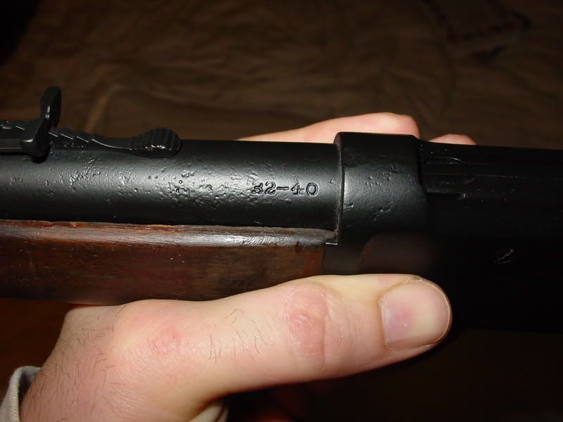

Here is a pic of the gun to show the pitting on the outside. The bore has been lapped and the muzzle now has a nice crown and is as bright and shiny as can be, and seems to shoot these lead pills nicely. Oh yeah, the barrel was originally 26" but is now 20" - so the velocities above are from a 20" barrel.

The pitting and beat up nature gives it a nice antique look IMO. Looks ancient, in a good way.

I'm tickled that old rifle shoots well. What is that finish? Looks like the color of molly coated bullets.
I'd be thrilled to take it hunting. If it could only tell it's stories, wow.

I am very pleased as well, I can't wait to take it hunting.
The finish is duracoat. When my cousin recovered the rifle, he put naval jelly on it to stop and remove the rust, but it was left on so long that the gunsmith had a really hard time getting it off, and by the time he got it off, he said he couldn't get it to take a blue at all, so he said that duracoat might be the only option. and since it couldn't really get much uglier, I said that was fine.
I have 3 lever guns and this one is really comes up the quickest and feels the best and steadiest at aim. I love the crescent butt plate as well.

Well, just for fun, I got the target out of my trunk and measured the group - it was 1 1/8" - not bad
The vertical shot string is me sighting in the 32 Special. I just put on a williams receiver sight and a millet front sight which was really tall, so I would file some down and shoot, then file more and shoot, until it made it up where it should be.

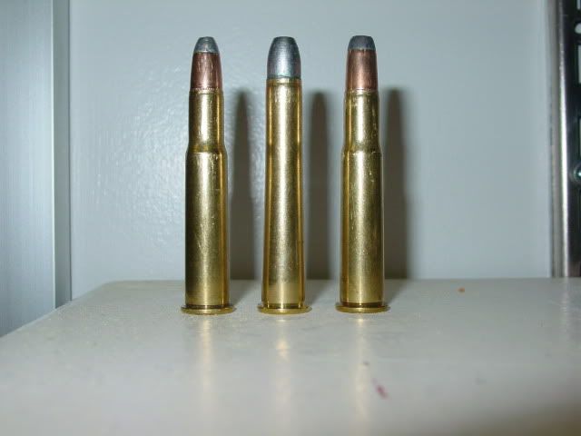

also, just for fun, here is a lineup of my levergun cartridges 30-30, 32-40, 32WS
you probably already would know this but the 30-30 is a factory winchester silvertip 150 grain and the 32WS is a factory winchester powerpoint 170 grain.
