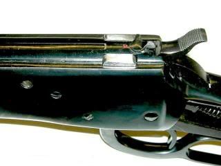

Or you can just remove that ugly thing, weld it up, and reblue it. Can't tell mine was even there on my .480 Ruger. :D

Great job but like most of the other here, I have neither the equipment or the skills to tackle something like that.

I agree, it looks like a great job you've done filling that hole. However, that area of the bolt is where the pressre is contained. If you didn't do it you may want to consider having the bolt stress relieved and re-heat treated. Welding on gun parts is done all the time and many of those welds are never treated but if the parts are pressure parts like this bolt they should be.
