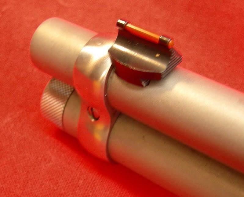

Pete44ru Do you have a photo of that sight? I have been thinking of one similar. :D

It's not a very good picture but this is my fix for the Browning.
Not exactly the same but it's a better picture of the actual sight.
Next option would be to remove the sight block and cut a dovetail then you could use just about any thing you want.

Nice Job Steve, wished we lived a little closer. I could keep you busy with some of my projects. Thats for sure.

NKJ,
That pinned on sight looks to be the way to go. The barrel is very light and I don't think there is enough 'meat' for a dovetail... 'least not with me running the file. :lol:
Thanks for the pic's :D
Looks like I will be using a marbles sight for the project, I like those serrations. 8)

I'm sorry, I lost a lot of my pics when a section of my hosting site had issues - but Kiowa's pics pretty much tell the tale.
FWIW, It seemed apparent to me that the square front sight post base of my 1975 B92 was hard soldered in place - the reason why I fitted an adapted sight blade ILO replacing it with a commercial bead like a Marble's, etc.
