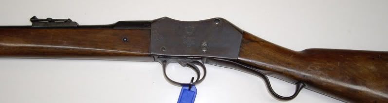

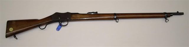

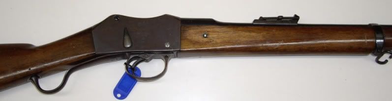

Just saw this for sale. It's a Martini Enfield - started out as a .577/450, was converted to .303 in the late 1890s and is now a .410 shotgun.
Do you think this would lend itself for use as a smoth-bore musket with cartridges made up on brass cases? Seems like it could be an interesting project......??

I would use a paper patch load to allow a bit of clearence to the bore. The action is strong enough for smokeless loads equal to black powder , but don't try to hotrod it. 303 cartridges didn't blow it up, but it's still a 100 year old gun.

303 cordite loads did not blow the action. Its very strong. The old 577/450 round was very similar to the old Springfield loads in 45/70. With respect to velocity/pressure etc. So keep that in mind and you wont go far wrong. In Australia there is a keen following for the 450/577 cartridge out of the old Martini Henry actions, they use smokeless powders and a 400g bullet. The charge being 37 grains of AR2207 for about 1400FPS. AR2207 being close to H4198 Reloader 7 or IMR 4198. Would like to pick one of these up myself one day. The action is strong, but if in doubt seek advice. Gunsmiths advice seems sound. Do some more research.
Theres plenty on the net on this action.

Can you post pictures of both action sides showing the stamps? The manufacturer's stamps will tell a great deal.
There are a number of "Khyber Pass" copies out there & it isn't advisable to shoot them.

Unfortunatley the gun is on the other side of the country from me. These are the only photos I have so far.
This shows the left side with the conversion cypher. I am awaiting further pics and info.
