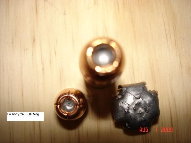

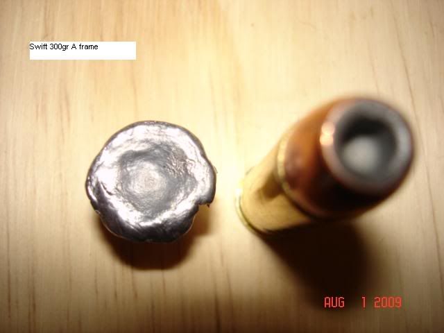

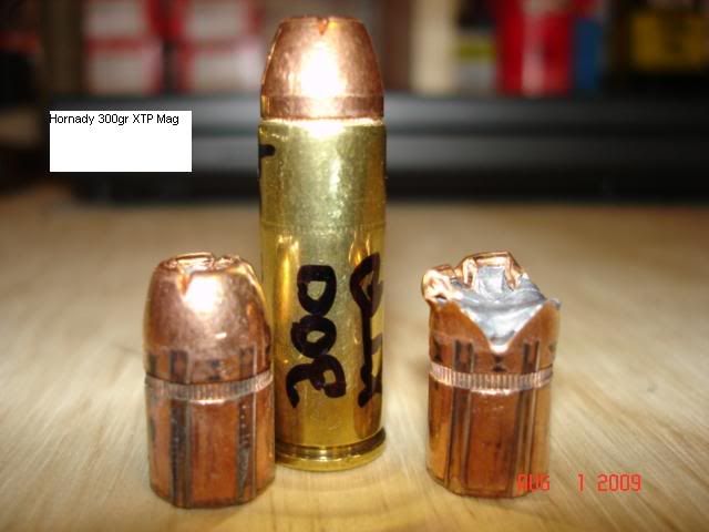

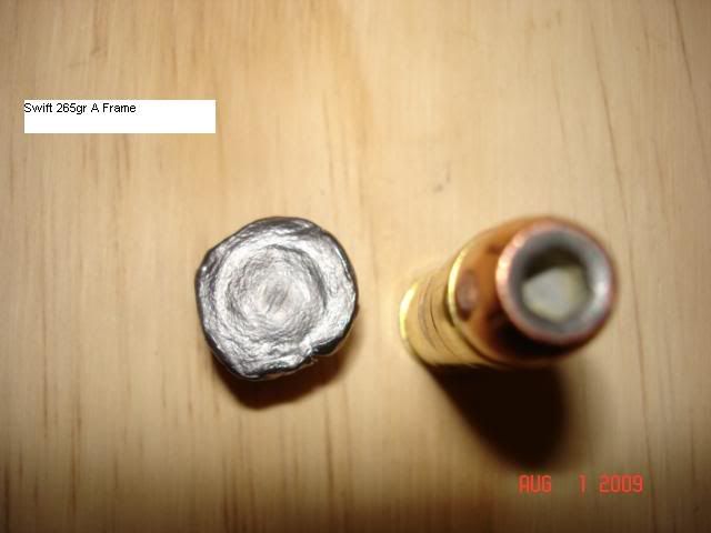

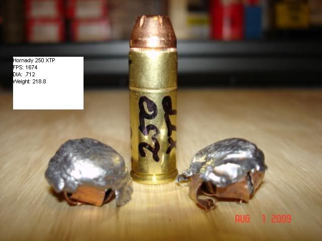

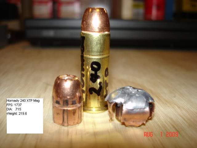

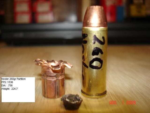

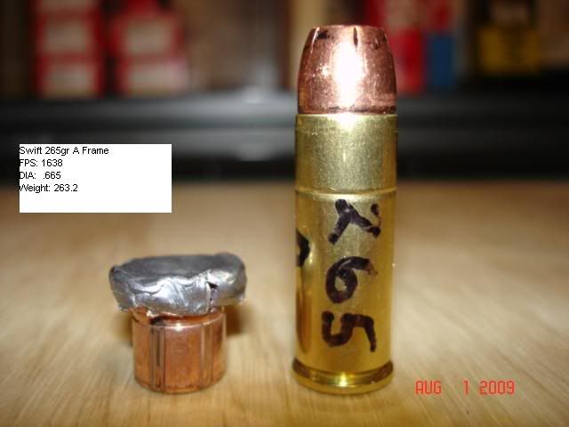

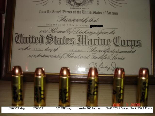

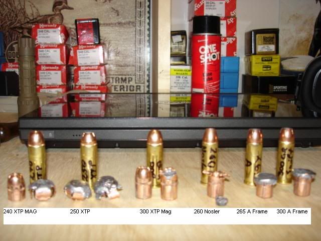

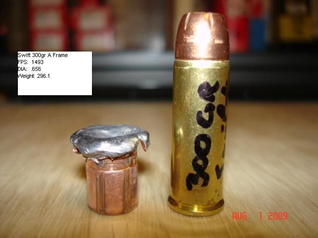

Well I spent my Saturday and part of Sunday testing 45 Colt bullets. I had mentioned in an earlier post that I wasn’t happy with the standard Hornady 250gr XTP. I felt from the results on raccoons they appeared to be a bit explosive causing me to wonder if they were opening up to fast at the speeds I was driving them. So I gathered up a sampling of what I feel are some of the better 45 Colt jacketed bullets. I acquired some Hornady 240gr XTP Mags, 250gr XTP’s, 300gr XTP Mags , Nosler 260gr Partitions, Swift 265gr A Frames, and 300gr A Frames. I want to thank cnjarvis who so graciously supplied the Hornady 240gr XTP Mags. All the loads used H110 for powder at a near max load. I loaded up 10 of each bullet. I just picked a load and used it; I was more concerned with pushing the bullet hard then with accuracy. My intent for the testing is to supply me with the data to pick the best bullet for my hunting situation, and then I will work up an accuracy load with that bullet. I want a bullet that will penetrate, expand, and hold together at the velocities that I’m getting with my Winchester Trapper for use on hogs and deer. I want something that will kill efficiently.
For a testing medium I debated whether to use wet news print or water. I settled on water as I couldn’t come up with near the amount of news print that I thought I needed for testing. Now I thought it would be no big deal stopping a .452 caliber bullet moving around 1500 to 1700 fps. WRONG! I started off with a plastic tub about 3 feet long. The first bullet to try was the 240gr XTP Mag, it blew through it like a water spout. I go down to the barn and find a second, and bigger, tub. I try another 240gr and the first tub blows apart but the second tub stops it but just barely. I tape up the first tub and put a trash bag in it to hold the water. Time for a 250 XTP……the second tub blows apart. I don’t have trash bags big enough for it so I go in the house to regroup and think, normally a dangerous thing. Then it hits me. I’ll build a water trap out of ¾ inch plywood and 1 X 12’s that I have left over from another project. I made the trap 12” X 13” X 8 feet long. I used at least 5 pounds of screws and a tube of caulk. I fill it full of water and touch off another 250 grainer. I wish I would have had a movie camera. Water flies everywhere, but it rips my high class water trap apart, stuff. About this time Joe (86er) shows up and says “ hey let’s put water jugs inside the thing water trap you built and shoot them” , well I was just about to do that anyway, or so I told him. Long story short, that worked out very well. So all the testing was done shooting though a piece of ¾ inch plywood into the water jugs.
Penetration was good with all the bullets but some were exceptional. The Hornady 240 XTP Mag and 250 XTP had the least with about 2 ½ feet. The first 300gr XTP Mag penetrated well but did not expand at all. The second one broke off parts of it nose. One of the 240gr XTP Mags also did not expand. The 260gr Nosler Partition penetrated good and expanded just as you would expect a Partition to do. Check out the picks below of the Nosler, pretty awesome looking. The Swift 265 and 300gr A Frames both penetrated very well with the 300gr winning out. Both A frames also retained their weight very well.
I came to the conclusion that for what I want out of a 45 Colt bullet for my trapper and my hunting situations is that the Swift A frames are the way to go with the Partition coming in a close second. The Hornady’s were a little disappointing in that the 240 and 300gr didn’t expand consistently and the 250gr didn’t penetrate as well as the others. The 265 and 300gr A frames only lost .6 and 1.3 percent of their weight respectively, but the worst was only 13.5 percent for the Partition. The only true disappointment was the Hornady 300gr XTP Mag. It acted more like a solid in this testing then a jacketed hollow point. Also take into account that this was a very small sampling. If I had the time and money I would fire more samples of each bullet and it could tell a different story. But I’m satisfied with it.

What are you planning to hunt with these loads? FWIW, the bullets are already .45-caliber, and have no real 'need' to expand. They start out bigger around than most .30-cal. slugs will expand to. I prefer complete penetration to expansion, anyway. Gives you two holes for the price of one shot. Don't worry about the drivel of "energy transfer" and all that rot. A bullet that penetrates completely 'transfers' as much -- if not more -- energy than one that stays in the animal. The one that doesn't exit just ran out of gas before it could leave the scene.
Most of the "energy transfer" referred to, is the energy required to deform the bullet, and has little to do with 'knocking down' an animal. 'Knock down" comes from hitting major skeletal structure or short-circuiting the CNS. No bullet you could fire from a shoulder-mounted firearm can generate enough kinetic "knock down" energy to flatten even a deer-sized critter.

Lucky you thought of the water jugs idea to save the day! I like the 265 A-Frames and the 300 A-Frame looks good on water jugs and worked okay on the Addax at long range. I don't mind the outcome of that NP either, although it did loose weight. Hey whatever you want to load us is fine with me.

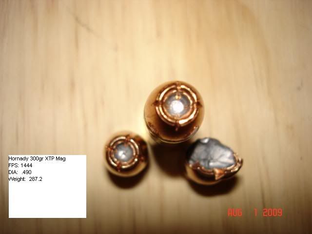

I wouldn't write off the 300 XTP just yet.
Don't forget shooting thrugh plywood and into water is not the same as
shooting into a soft skinned animal.

Buck, i don't hold much in the energy transfer stuff either, what I do know from my own hunting experience is a good expanding bullet kills better. As I said in the post I'll be hunting hogs and deer mainly. My problem with cast bullets is just what you said, it's a 45 caliber bullet making a 45 caliber hole. Why not use a 45 caliber bullet to make a 60 caliber hole and still penetrate completely. My whole intent when I shot something is to put it down RIGHT NOW, not 150 or 200 yards later when it bleeds out in a thorn thicket that you need a bulldozer to get your animal out. A good jacketed bullet is always my choose over a hard cast for hunting.

RKrodle wrote:The only true disappointment was the Hornady 300gr XTP Mag. It acted more like a solid in this testing then a jacketed hollow point. Also take into account that this was a very small sampling. If I had the time and money I would fire more samples of each bullet and it could tell a different story. But I’m satisfied with it.
I didn't write it off. But I don't believe I can push it fast enough to make it expand reliably. The only bullet out of these samples that I ever recovered from an animal is the 300gr A Frame and it expanded nicely then also.

I've had similar experiences with the 300XTP Mag in 45 Colt revolvers. They act like a solid at lower velocities. I use the 300 XTP non-mag for my self-defense loads in 45 Colt. I've not recovered one but I suspect they open up much better at slower velocities. They might open up TOO MUCH at 45 Colt rifle velocities. I don't know.
I have found the 300 Mags open up very well at 1550 + fps. However, at the just under 2000 fps I can get out of my Puma, I have reason to think they might open up too much judging from how the water jug exploded and the water was partially VAPORIZED! Never seen any bullet do that on a jug before or since.
It would appear that every bullet has a sweet spot of velocity that it works well in.

Yup, velocity is the key word here. Within the proper speed envelope, they all work. Miss the speed they like, they don't. I like the 250 XTP at 1200 to 1500 fps, much below or above that it isn't ideal. the tougher bullets are a rifle-only proposition in .45 Colt, needing casull velocity to work WELL in handguns. If ya MUST have a good expander in .45 that works well in handguns, get the 230 XTP designed for the 1911. It's gonna bloom like a spring rose at 1100 fps or so outta a revolver, and is absolutely nasty at 1350 or so downrange velocity in my c45S cases out of the rifle (but would blow to hell and back at hot long colt velocities. Come to think of it, the 230 XTP would be ideal for use in a 66 or 73 where the gun is restricted to lower pressures.

Great report Ricky! I've been waiting anxiously on it since I sent you the bullets.
I have to say though that I'm disappointed in the 240 XTP Mag's performance for you. I had expected better. I do wonder if water is the best medium though but the 3/4" plywood should have initiated plenty of expansion. Perchance did the unexpanded bullets pass through a hole from a previous shot? That might account for the lack of expansion.

cnjarvis, the unexpanded 240gr XTP Mag was the very first one shot. I was pretty surprised also. It had the fps and I thought it would open well. But also remember this was a very small sampling of each bullet and could of been a fluke. With your hunting success with it I wouldn't see any reason to stop using them. If you don't mind me asking, what kind of speed are you getting with yours? The only bullets of this group that I would hesitate use would be the 250 xtp, I think they would perform better at slower speeds, and the 300 xtp mag. The 300 may work better at higher speeds that I can't get with my trapper. I was really happy with the A-Frames and I thought the partition worked well.

Ricky, I'm getting about 1900fps 10 ft from the muzzle out of my 20" carbine.
