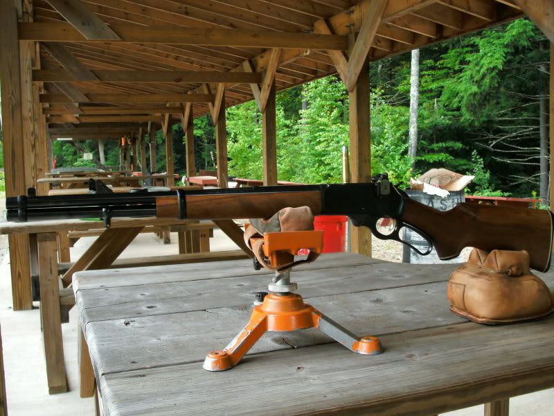

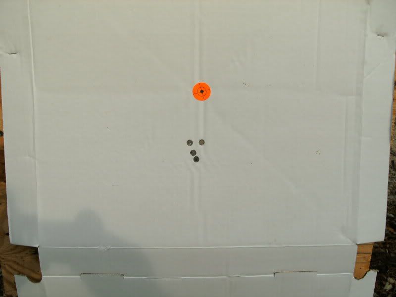

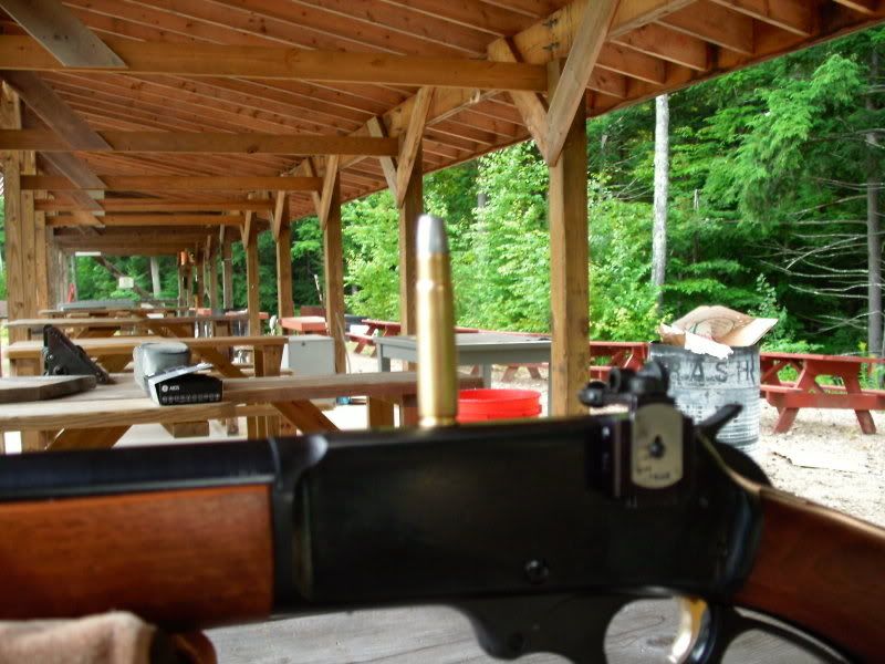

I found this circa 1976 336 .35 Rem. some time ago. It was in need of some T.L.C. The wood was weathered and well used. There was much minor pitting on each side of the receiver. The action was good and tight and the bore was perfect. A good price made this gun a prime candidate for an over haul. Multiple coats of tung oil made the wood nice and pretty. We shortened the barrel and mag. tube to 18", lightly tuned the action and trigger. No race tuning here just some light, practical massaging. A trip to the buffing wheel and reblue tank rounded out the project. The final touch is a Lyman receiver sight. I took her to the range this A.M. for a little work out. My favorite, heavy duty cast load for modern Marlin 336 .35 Rem. was in tow. A Mt.Baldy 230gr wide flat nose gas check sized .359", Rem. brass, a healthy dose of H-4895, and Rem. 2 1/2 primers. Velocity runs at 2100f.p.s. adjusted to the muzzle. Target was shot at 50yrds from the bench. 1886

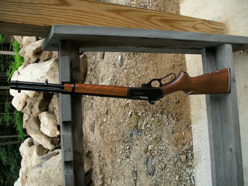

Thanks J. I wanted to replace the forearm band with a newer, "stud installed" model. I could not get the band pin to fit properly. I will have to work on that later. The barrel band stud hides a small amount of pitting that we forgot to buff.? 1886.

:D That looks great and shoots good groups. If it were me I would put a new front sight on it with a gold bead. But that is up to you. Over all I would say that is a very good job. :D

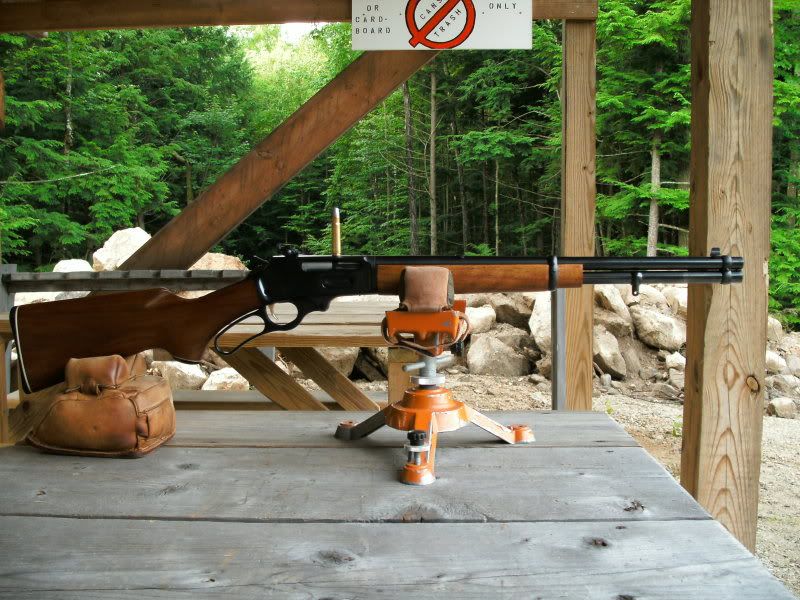

Did you slim up the forend or did it come that way. I personally like them wider, but that's just me. :P

Gary, That is a great looking rifle and apparently a good shooter too. I take it that is the one you told me about some time back. You have to love those 35s.

44magHunter wrote::D That looks great and shoots good groups. If it were me I would put a new front sight on it with a gold bead. But that is up to you. Over all I would say that is a very good job. :D
It has a Lyman white bead or as the beautiful people say, "faux ivory". The bead made it a little tough on the white pizza box background. The bead shows up well in the dark or against the fall hide of a northern whitetail. 1886.

44magHunter wrote:Did you slim up the forend or did it come that way. I personally like them wider, but that's just me. :P
That is the way it came from the factory. Some guys do prefer the perch belly forearm. 1886.
