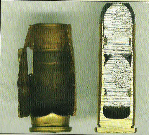

In case anyone might be interested, I think it would have been impossible to seat two 290gr SWC bullets in a 44 mag case.
When loading the ammo, I would take a bullet and put it in the mouth of the belled case, while in the loading block. Would also be tough to get two bullets in a case that way.

The double-bullet seating I have heard about took place in progressive reloaders. A buildup of bullet lube in the seating die pulled the bullet and left it stuck in the die.
The reloader, not noticing, thought he had forgotten to put a bullet in the case so he inserts another and presto!
