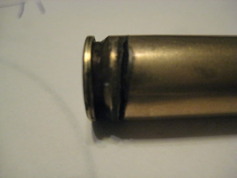

I'll start with the bad first, Took my Browning 1895 out for its first shoot, Loaded up a few different loads and got it sighted in with a promising load of 56.5 gr. - IMR 4831 - 180gr. BTSP in military brass that was given to me. Shot 5 or 6 to adjust the sights, it walked right in to the bulls eye @ 50yds. I then started a 5 round group and on the 3rd round I noticed smoke coming from the receiver and the ejector quite working! Looked at the case and had a case head failure!
I'll need to take the 95 down and see what is wrong, I'll let you guys know what I find hopefully it did not screw anything up to bad :x
I guess I had better pull all 150 rounds in the Military brass and start over with new commercial brass.

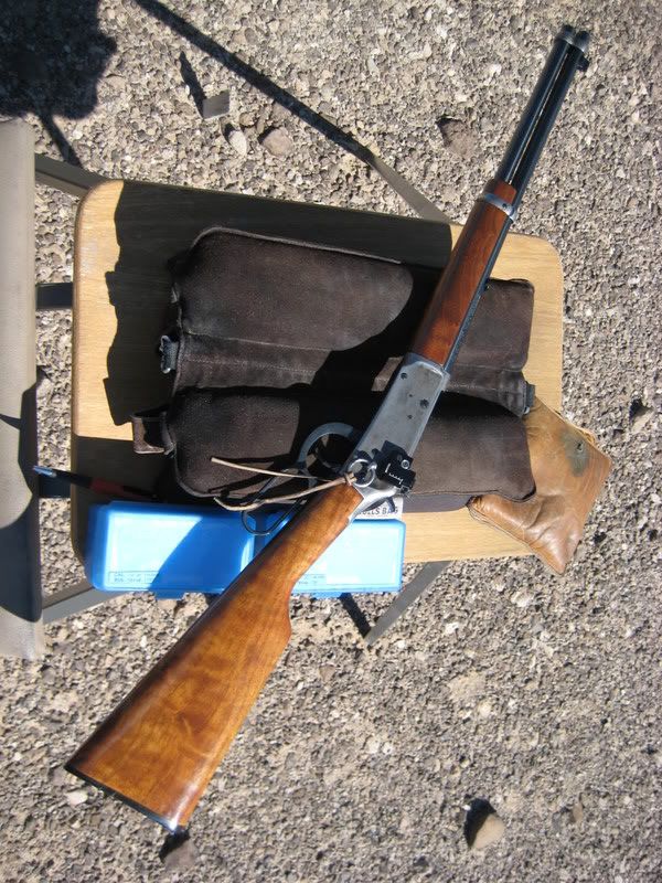

Put a Williams FP on my 94 Trapper 30-30 and sighted it in, I only shot @ 50 yds. with two loads. It seems to like 150's and 170's about the same

Yeah, I really like the Landcruiser - wow. Too bad about your 95 - I'm sure the extractor is probably sprung and you may need a new one - but it could be a lot worse - glad you didn't get hurt (thank you John M. Browning!). I would definately pull all of those loads - no need to throw the brass though - just back off on the load - they have thicker case walls and therefore less capacity which leads to higher pressure. But then you know that now. :(

Check the head space on that 95, but it will probably be OK. You never know what military brass was fired in. A little trick is to unfold a paper clip and use the end of it to feel the inside of the case. If you feel a dip or grove just above the web, scrap the case.

YK, I was standing on the bench seat and almost took a dive, I don't know how my feet missed the pics :D I counted the ones I need to pull it came to 94! I thought I backed off enough on the load, StevesPages http://stevespages.com/308_8_180.html
Showed IMR-4831 From 46.5 grains to 59.2 grains. My 56.5 grains just was to hot for the thick military brass (Big lesson learned)

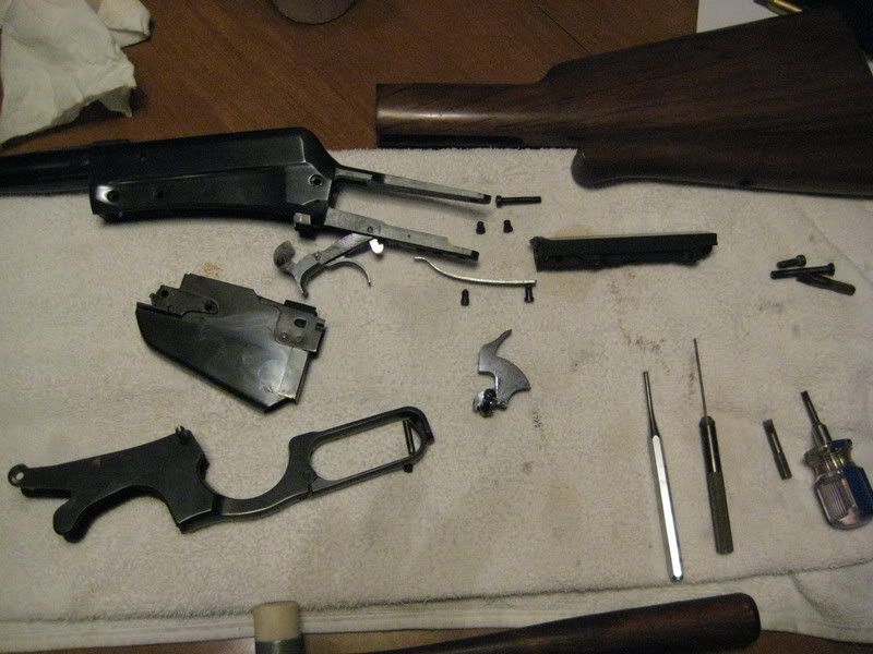

I took the 1895 apart, what happened was the gas from the failure was able to push the ejector further back and down and the ejector was able to catch on the bolt. When I lightly pushed up on it, it popped right back into place. I could have done that without taking it apart, at least I checked every thing and cleaned it up. I was lucky!

I was surprised at how easy the 1895 comes apart and goes back together!

That there brass! It may be weakend by corrosive primers from a long time ago maybe!
