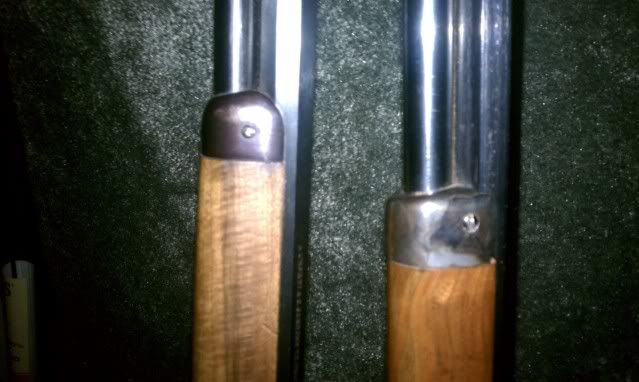

That's the way mine is, it actually on catches on one portion of the dovetail... not tight at all, yet when the forend and cap are in place... doesn't move a bit. Strange. However, I really like the look of the older style forend cap over the commemorative version. :D
Is mine the older style? What is the difference?

Posts: 21395
Re: 38-55 Project
Rube Burrows wrote:Is mine the older style? What is the difference?
I am looking at some on GB right now and I am thinking mine is the older style?
Here's an older style on the left and a commemorative on the right.
(Sorry about the slightly blurry cameraphone pic.)

Post by Rube Burrows »
Thanks for the pic. I can def see the difference in that. I like the original also.
