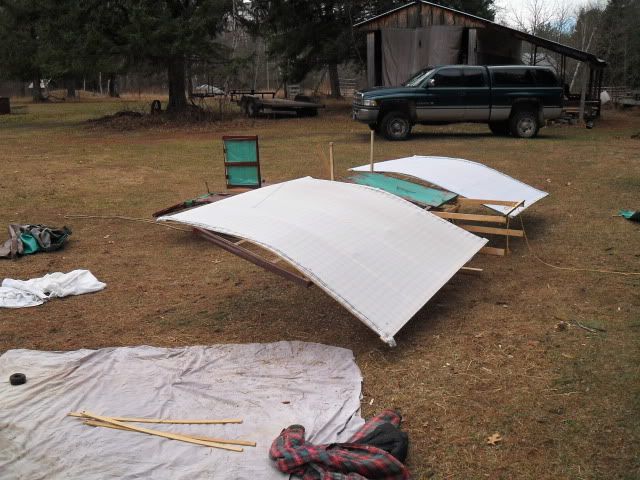

Check out this wing boys.
Test tow coming soon.

So Grizz why wouldn`t it lift better, nice curve and more area.
Suppose those bed sheets let to much air through them?
Re: The Pitchy Plane Project
When it was on the tractor? Not enough airspeed for one, plus I think the wings aren't rigid enough and may be stalling themselves when they're flexing. And yes, they need to be airtight.Pitchy wrote:So Grizz why wouldn`t it lift better, nice curve and more area.
Behind the atv? Not enough line for one thing. No lateral stability for another.
Wings are built sort of like a box beam. When jet liner wings and sailplane wings flex they are still maintaining the lifting shape. It appears that when your wings flex they're sort of flapping and twisting.
Really light model planes will fly with dead flat wings that have no lifting shape, they're so light that the rubber band and prop overpowers the weight factor. But the wing covers are airtight.
The ones that fly really have a certain shape, and tightly stretched fabric that is painted or doped to make it airtight and watertight.
You could make some model wings and hold them in front of a fan and you'll be able to feel the lift effect. A lot of the effects of design changes will scale up. That's how the Wrights did it, they measured the lift of their wing designs in a wind tunnel they built.
Best

Gliders can fly without aileron control if they are perfectly balanced aerodynamically.
Looking at your wing again it appears that the highest part is almost in the middle, is this correct?
I believe the best lift will be with the highest portion of the wing between a quarter and a third of the total distance back from the leading edge.
You can probably find stuff online about low speed wings. The goat's wing falls in that category and you can see in the drawings how it's layed out.
Here's the CH 701 wing form. It will fly without the accessories. It is specifically for low speed flight.
Is this similar to your wing design? I can't tell for sure from the fotos.
I know you'll get it workin.

That being said the wing is curved with the high point in the middle, i figured it would catch enough air to lift it the way it is and i`m sure it will in a gusty head wind.

This is why the Wright bros. made a wind tunnel. You can see a replica of it at the Air and Space Museum in VA. It's pretty cool.That being said the wing is curved with the high point in the middle
With the high spot in the middle the wing chord is effectively shortened because the extra surface in front of that spot isn't helping provide lift. You can test this.
I'm with you in experimenting and discovering something that works. That's good stuff. But I don't see you welding up the cylinder on your revolver and putting flint ignition behind the bullets.... know what I mean? There's a 100 year history of flight where basic principles are pretty well hashad out. Not saying there's no room for innovation, there truly is an amazing variety of ways to make flight work. They all have certain things in common.
Like, we don't put the bullet in the case and the powder on top, that kind of stuff in common. Imitation of successful precedents isn't cheating. There have been flying replicas of the Wright Flyer. They had those certain basic fundamental things in common with the original Flyer..... that's why they can fly.
BTW, it's amazing to visit the museum in Kitty Hawk built on the site of their first flights, and to see the stone markers that show just how short that hop was. Stunning that it wasn't all that long ago.
I hope this is encouraging to you 'cause I love seeing what you can build, and I might be your biggest fan in the flying thing. Definitely want you to succeed.

I understand what your saying and agree, i just don`t want to put any money into this and its a learn as i go project.
What i`m going to do next is spray the wing with some shellac to seal the cloth a little, i have some on hand.
Then i`m going to wait for a windy day and we will put a person on each wing tip and pull it at walk speed into the wind and see if it will lift. That way we won`t damage it as with trying to tow it fast.
I`ll see what i can do to make the wing higher in the front.

Interesting, ya can picture the Wrights trying different wing shapes in their wind tunnel.
Speaking of wind tunnel, maybe that would be cool, find a huge fan and put it in the end of a building and fly in place.
I lowered the front of the wing some, i think it was at the wrong angle to create lift and am now waiting for a windy day to try it again.
Thanks gents.
30-45 MPH wind today so will be taking it out to see if we can get it off the ground, empty.
Didn`t get er done, had to go to the dentist and have a flap done to grind part of my jaw bone away
