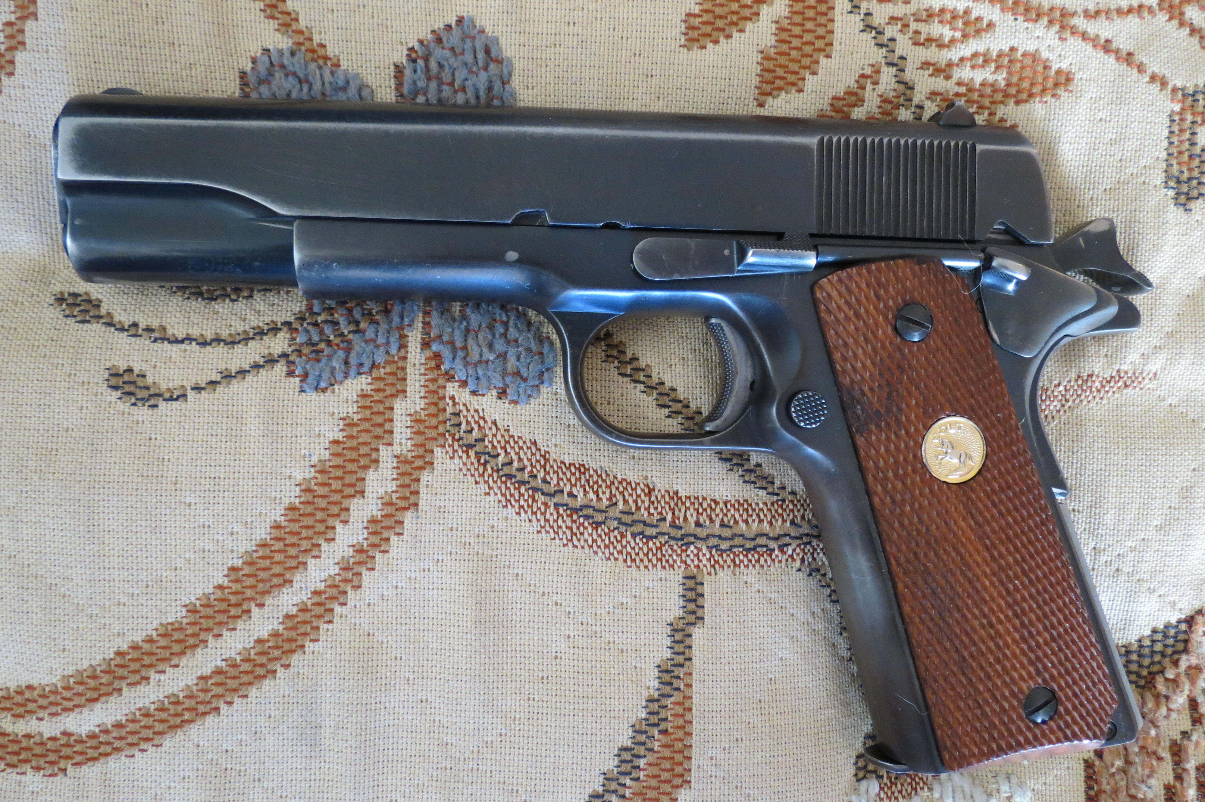

Bill... 5 minutes with a file and you can stop that blood-letting.
Unload the gun .. pull the hammer back as far as it will go. Mark how much metal to remove and using the file carefully, trim the back the hammer spur, starting underneath. Shape it and it is not noticeable.
I did it to this one..

Jim, is it that easy? Good gracious I will work on it. With their 1911 A1 U.S. Army model, Tisas copied nearly every detail of the Remington Rands made starting in 1942, including the flat-sided Type E hammer. I have read they are actually making them for the CMP. Tisas abandoned MIM parts a year or two ago, which I appreciate. So you just take a little off the back flat of the spur with a fine file eh?

Shorten the spur a little so it doesn't come back so far and then take metal off the underside and shape it so it looks close to the original shape. It's not a lot of metal to remove. Just enough to keep the hammer from biting you.

Here's one that has been modified ala Jim's suggestion:
Bought that war surplus 1911 Rem Rand back in the mid 60s. It was in a pawn shop. When I asked to see it the owner pulled it out of the display case, inserted a magazine, jacked the slide back and shot it into a 4" think piece of wood on the wall with a playing card tacked to it. Scared the stuff out of me, my buddy who was with me and an old lady browsing the jewelry display case. Would have been half a dozen swat teams surrounding the place if done today.
Had no idea at the time that it might eventually have collectors value. Spent the better part of a summer with stones and emory cloth removing the parkerized finish. It has been reblued a couple of times. Left it with my dad when I went in the army and the old swamp cooler left a thin film of rust which I dutifully removed and had it reblued.
Not all original - different grip panels, main spring housing, vintage target hammer (with Jim's suggested mod). Used to buy army ball ammo from an army surplus store (buck a box of 50 if membor serves). Brought back lots of good memories.
Haven't shot it in ages. Will have to drag the old girl out for a bit shooting.
