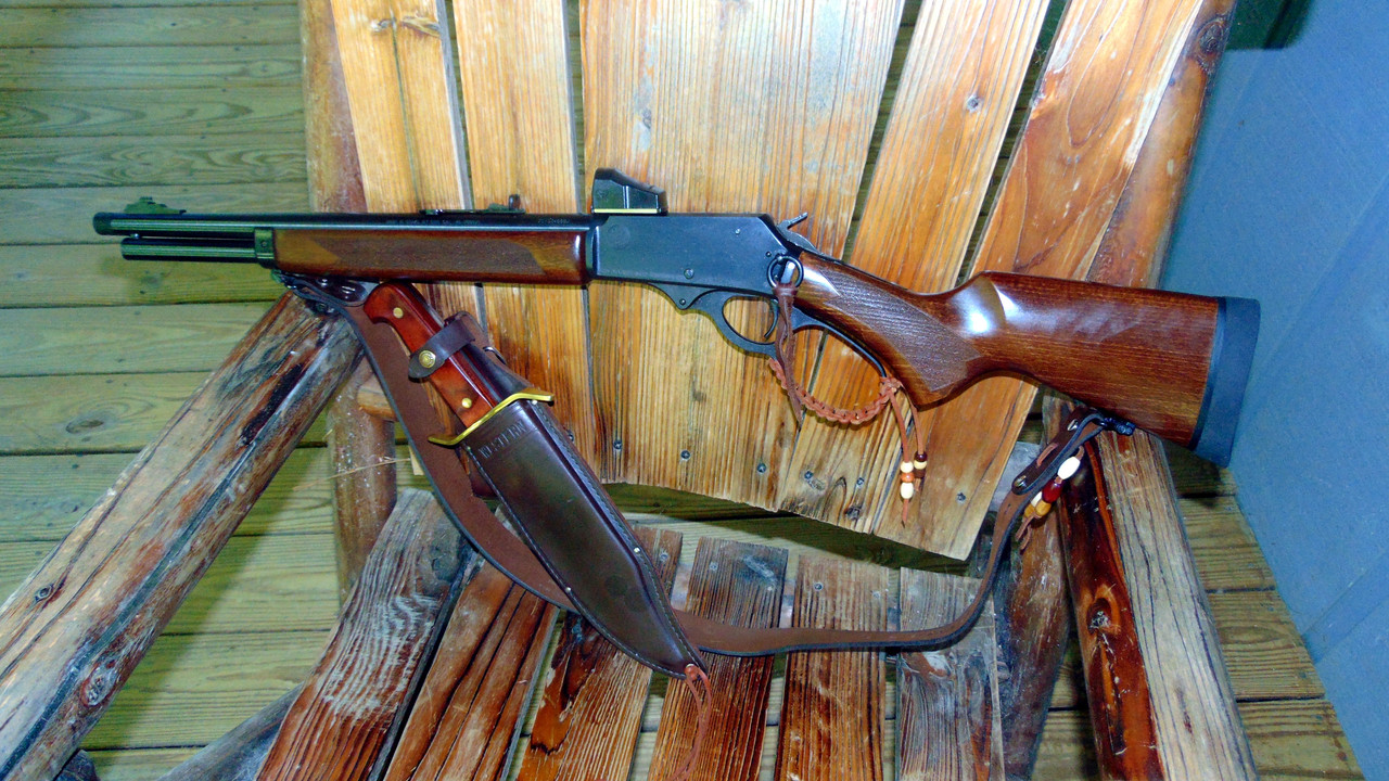

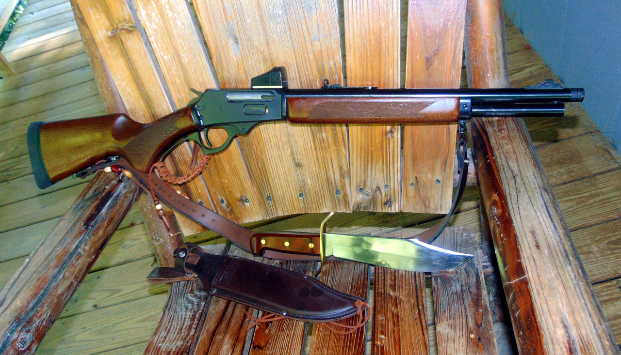

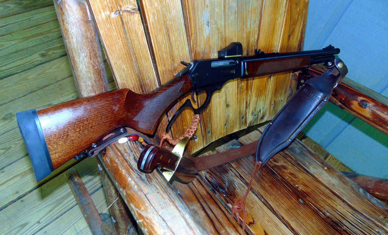

I have made it mine and there are things that I did that I wonder how many of you guy's have done or thought about doing. Here is my list of work that took me a lot of time Saturday the first day I had it. Maybe shoot it Sunday for the first time.
1. Cut the LOP down to 12.5" and fitted a new Limbsaver Recoil pad to it. Total LOP 12.5"
2. Wrapped the Lever in leather and Mink oiled it so it will not rust the lever.
3. Drilled the sling stud on butt stock out to have it moved and filled with wooden dowel (walnut) and sanded even

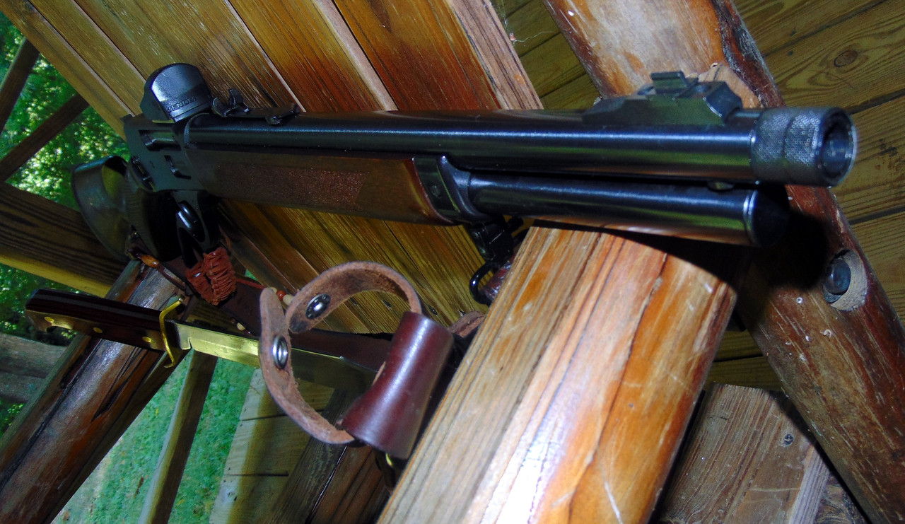

4. I have had a RMR Vortex for a few years that I never used because I did not like the height of it on a rail. So I had some 1/8" brass plate that I mad a mount for it from. See it in the pictures.
5. I replace all my 92's and 95 safety with a Saddle ring safety delete. I was going to buy one when I realized I had a spare drill and tap saddle ring in my parts drawer. I ended up taking the safety out and decided to drill and tap the safety to put the saddle ring on it. That safety was so hard that I burnt up two drill bit before I decided to heat the safety button up with a torch and then it drill easily. I then tapped it cleaned it up and re-blued put it back into the rifle. In stead of using the ball bearing and spring I took a small piece off one of the burnt up drill bits and made a short rod and the Allen screw to securely lock the safety in the fire position. Just like the safety delete does. Anyway Love the way it turned out and saved me $50 counting shipping.
6. Drilled and moved Butt Stock sling swivel.
Guy's like the way she turned out and she is my tyle rifle now. She fits my smaller frame body very well.

Thank you for going with a dedicated red dot mount instead of just doing picatinny rail. I drives me nuts when people do that. There are dedicated mounts if you look long enough on the internet. That's a good looking build.

That long sweeping pistol grip reminds me of a 71 long tang. Very nice looking setup. Probably swings on target quickly with short barrel and the red dot.

Thanks, I had this red dot sitting around for ever. It came with a mount on it but after using a rail with that mount it always set way to high so it always got benched. I know there are mounts out there but I still did not like them as far as height went. I just decided to make my own for it out of the approx.. 1/8 " brass I had laying around. Worked well and sits low where I still get a great cheek weld and it perfect for me. Happy with it, very happy with it.
Rimfire McNutjob
Yes handles and very easy to maneuver, I am a shorter individual 5'5" tall/short so my LOP is only 12.5" from the crease of my elbow to the trigger finger. The shorter 16" barrel and adjusted LOP to 12.5" is a perfect setup for me also. That way I can lever the rifle while still on my shoulder.
Really liking this rifle, it is the only one setup with the red dot out of all my levers that I own. This is also the shortest barrel out of the three 45/70's that I own. Really works and handles well. We will see how that red dot holds up. Right now I am shooting Marlin/1886 loads only out of my three 45/70's (this R95, Rio Grande SS and my Winchester 1886) I am getting ready to load or should I say down load about 50 rounds to a more mild shooting round.
