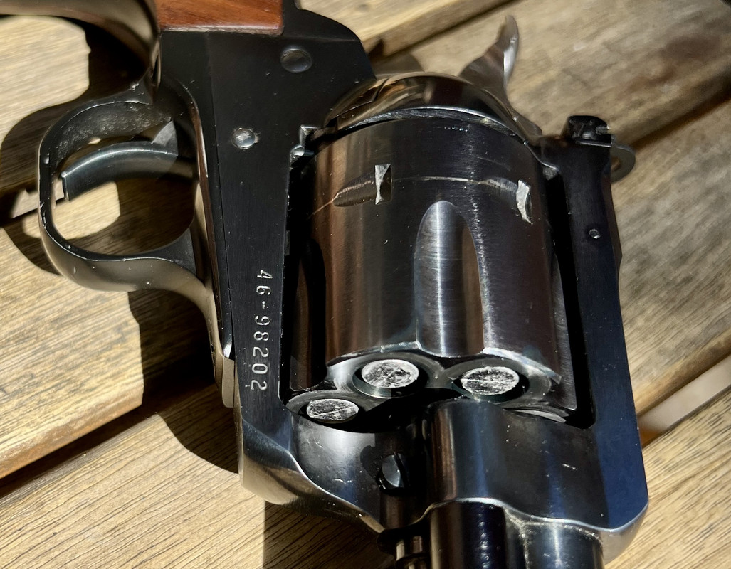

I finally got around to figuring out why the excellent boolits from my Accurate 41-240V mold, carefully handloaded, would not chamber in my Blackhawk, when loaded to normal OAL: cylinder throats are .409-ish. I thought this garbage issue was mostly limited to Ruger's crummy .45 Colt cylinders, but nooooo. They apparently cheaped out and used their gang reamers until they were worn out on other centerfire single-action revolvers.
I sent my cylinder off today to a gentleman in North Carolina who uses a Sunnen hone to correct the egregious Ruger factory sins. Will report when I get it back. The bloom is getting pretty well off the rose with me regarding Ruger centerfire single actions. I am tired of dealing with their sloppy messes. Rugers are not quite the Yugos of the gun world --yet.

Well, boys, I got my cylinder back from Doug in the mail this afternoon -- nice turnaround -- and the chambers not only looked beautiful, but the handloads with that big old Accurate 41-240V boolit dropped in like they were born there. Before, they would hang up a quarter-inch or more when chambering and would go no farther. There is something comforting to me about a sixgun with big, wide meplats greeting you from the business end of the cylinder.

Re: Fixing my .41 Blackhawk
Glad you got it running again.
As to those bullets, When you care, send the very best!
I really like it when my bullets fill the cylinder like that.Bill in Oregon wrote: ↑Wed Apr 12, 2023 4:30 pm Well, boys, I got my cylinder back from Doug in the mail this afternoon -- nice turnaround -- and the chambers not only looked beautiful, but the handloads with that big old Accurate 41-240V boolit dropped in like they were born there. Before, they would hang up a quarter-inch or more when chambering and would go no farther. There is something comforting to me about a sixgun with big, wide meplats greeting you from the business end of the cylinder.![]()

Great Bill! That bullet looks NICE! I need to look for a heavy 41 mold.
