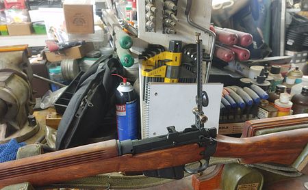

My goal has been to design a cartridge where an Enfield #4 Mark 1 or Mark 1* could repeatedly shoot the steel targets at the Friends of Billy Dixon Ultra Long Range Shooting Facility in Hotchkiss, Colorado at 1538 yards with iron sights. Just for a review for those unfamiliar with the shooting range, here is an ancient article I wrote years ago with McPherson. We have quite a few upgrades at the range since that time.

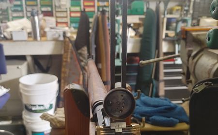

We need to cut a relief in the bottom of Randy''s adapter to clear the bolt lug when rotated up to pull the bolt out of the gun, but so far, the gun can function the action correctly with it mounted. The color case hardening and brass components on the staff really complimented the brass parts on my rifle.

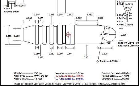

Today, we reached an important milestone in this project. My new "heavy weight" 303 bullet design is completed by Todd Corter. I have named it the TC Torpedo for now (which can stand for Todd Corter or Tutt-Corter). It is 1.5 inches long, designed at a diameter of .315 that can be swaged down when lubed, and weighs 259 grains predicted at that size. It has an almost perfect 48.62/51.38 center of gravity and way better balanced than any Spitzer bullet. I ran it through again at 261 grains (It picked up 10 grains of weight in the latest revision from the 249 grain weight prototype) through both a Greenhill Calculator and Berger's Miller Formula Calculator using the factory 1:10 twist. It should work at our projected velocity of 1600 fps with Blue Dot (slower is better sometimes and why I needed the longer sight staff). I can also load this bullet to the same pressure with Varget and have it do 1900 fps predicted. This would make a dandy hunting load.
Here is the TC Torpedo:
Next, off the design goes to a mould maker, probably Tom at Accurate Moulds. From there to Matt at Matt's Bullets. Hopefully I can get some to test by Easter Break at FoBD.
I intend to make it available to anyone who wants to try it, and is partially the reason I had it designed over-sized at .315 so it can be swaged down to what someone else may need. I will probably have mine done at .314. My barrel is choked at .305 at the muzzle, so we narrowed and tapered the round nose from .302 to .301 to .30 so that part of the bullet is not touching the rifling. This is what they call a "bore rider" design. There is an extended 45 degree scraper grove just ahead of the front driving band and a cut behind it to relieve bore to barrel friction slightly and maybe provide a place for displaced lead to go. It should seat deep enough into the case where all the lube grooves are protected below. This is really meant to be a target load with no crimp, just an interference neck fit, and fired extra long COL in single shot mode, but it could be adapted to work as a magazine load for hunting too I suspect. We tried to leave enough bearing surface there in the front driving band to do that and seat it deeper. A Lee FCD could probably do the job for a crimp, or maybe a Redding Taper Crimp die, I will have to see. That's not what I am really designing it for right now? But will be the next logical step in the process. I tend to design my custom loads for long range target shooting first, and hunting purposes next. You can have both actually with some work and research.

Mic McPherson with trigger job and help with bullet design and instruction using Quick Load over the years.
Todd Corter for bullet design with some input from me in length and front and rear bullet profile.

Really love that new sight. Nice to see a finely machined and fitted piece of equipment,
Looking forward to the availability of your bullets, really want to try them in the 7.62x54r rifles. I missed out on a Finn match rifle a couple weeks ago, got busy and forgot that the auction was ending. I see the Model 28/76 pop up about once or twice a year for sale. I'll bag one sooner or later.

That was funny Jim! Here's another rendering. -Tutt

Ray Newman wrote: Thu Apr 14, 2022 4:30 pm Tutt: interesting campaign you are embarking on. I wish you success.
Does the front sight or the barrel have a spirit level to prevent “cant”? For those Not-In-The-Know about “cant”, see: https://www.chuckhawks.com/canting.htm
Speaking about a 1-mile shoot, there also is the Wasserburger Mile – Black Powder, lead bullets, and iron sights
https://www.youtube.com/watch?v=JmSHobmGDew
Results of the 2021 Wasserburger Mile shoot:
https://www.shilohrifle.com/forums/view ... hp?t=28281
Ray, its Tutt or Andy. I won't permanently modify the front sight of this rifle. It's simply too pristine. I won't make any permanent changes to the rifle for this project, so I am limited by my decision and the historical value of the rifle. The rear sight adaption to a Kelley Soule sight has pretty much already been done by Randy Arnt, a member of the Shootists and a remarkable machinist.
http://kelleysights.com/SouleSights.php

I thought I had finally found a mold maker who could do this design, but I may have been mistaken. Waiting to hear back. -Tutt

CowboyTutt wrote: Mon Dec 13, 2021 10:32 pm
But 1500+ yards with a 30 caliber? ......you need more mass....and a lot more velocity for shooting that far....----002
Hey my friend, first off, length of this bullet is maximized for the twist. That decision was on me. The weight is what it would be. I know it sounds counter intuitive, but what McPherson has seen is that when the velocities are too high to begin with, when the bullet goes trans-sonic, and subsonic, it can often destabilize. It is not a particularly scientific and measured discussion based upon data, but what he has seen. And what he has seen is that slower moving bullets do better when going subsonic.
This might be because the bullet has more time to stabilize after it goes subsonic before it hits the target, if it is well balanced. This bullet is extremely well balanced so hope for the best. At ranges beyond 1538 yards, I have to wonder if the Varget load might be the better one at a predicted 1900 fps, which is the ragged edged of a non hard cast bullet.
There are all these theories out there, what McPherson offers is actual experience shooting so many different rifles and loads at extreme distance. Even he is the first to admit, it doesn't work until you test it.
Regards,
-Tutt
Plus, look at the people shooting 6.5 mm, 7mm, and the not-that-much-bigger 338's at very long ranges. Seems like the key is the long, streamlined, heavy-for-caliber bullets will maximize long-range potential if spun fast enough to stabilize, within whatever diameter/caliber you select. The bigger ones do have a clear advantage, but why do things the easy way... :wink:

Thanks Guys, it turns out that Tom at Accurate is not only limited in making a round nose, which is no big deal, but his bullet length is limited to 1.375, and my bullet is 1.5 inches long, so going to keep looking....again! Bummer, -Tutt
