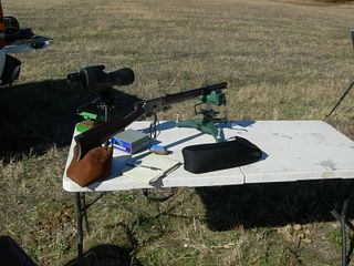

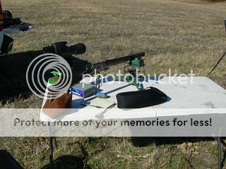

I was a bit disappointed with my shooting, the target, and both sights were a blur... must be time for a new prescription! I'm still waiting for my phone to email my pictures to my laptop so I can share them... In the meantime, the results for 9 rounds were: Ave - 1532, Hi - 1574, Low - 1496, ES 78, SD - 25.27, AD - 24. (Round #1 didn't register on the chronograph). Frankly, none of the fired brass exhibited any signs of even moderate pressure. Primers are sort of flattened, but still exhibit rounded edges and a full roundness to the primer strike. There is a bit of soot down the sides of the majority of cases, indicating the case mouth didn't completely seal the chamber. There is a very slight bulge to the walls of the case where the usual max chamber meets fully sized case.
I shot the 1st 3 shots low into the 4 & 5 rings (from the horizontal centerline). at 6 o'clock to 7. I then adjust the rear sight up 2 notches and shot #4 was @ 9 o'clock in the 1 ring (counting rings from the vertical centerline. Shots then strung along that vertical line, left of center.
I then got the Miroku 1885 in .32-40 out of the case and fired about 30 rounds thru it. They were all loaded with a 170 grain RFN from Missouri Bullet Company, 10 rounds with 5744 and 20 rounds with 3F APP. Better than last time, but a little fast. The smokeless worked perfectly, the 5744 averaged 1449 fps with a AD of 17, the BP was "okay", but of the 30 rounds only 17 measured on the chronograph. And two of those fell around 800 fps lover than the average. And it wasn't a measurement error, I could definitely tell the difference in both sound and recoil. They were very soft. I can't figure out why, as all rounds were volume measured @ 40 grains. Except for those low speed rounds, the APP rounds averaged 1663 fps, with an AD of 41.4.

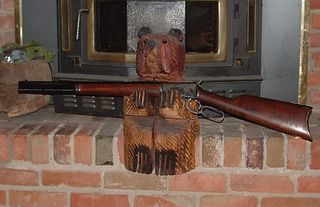

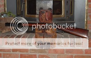

Griff, I ran the numbers in Quick Load with a Speer 250 grain HP Gold Dot, bullet number 4484, 16 grains of Blue Dot out of a 20 inch barrel. Not sure the bullet is exactly the same thing but closest I could come in the pre-loaded data base. Predicted velocity was 1514 fps so your right in there. Pressure was only a very modest 21886 psi predicted. 16.9 grains predicts 1582 fps at 24841 psi. Ruger only loads in 45 Colt tend to be around 30K psi so your well in the safe zone if your rifle can handle a Ruger load. I'll PM you my contact information again, so you can write or call and I'll do what I can. -Tutt
- Posts: 21456
Re: Mcpherson on Leverguns
Thank you Tutt. Yes, the Rossi '92 seems to easily absorb this level of power. It's heavy octagon bbl and full "rifle" furniture even with it's curved buttplate weighs enough to absorb quiite a bit of recoil. I bought this rifle for my son in 2004 for him to shoot Wild Bunch with and slicked it up much the same as I did two earlier Rossis in .38/.357 that were his and my wife's cowboy action rifles in '87 & '88. This one I left a little tighter with the additional idea of using it on hogs here in Texas.
