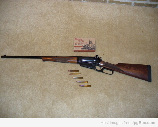

1.A Miroku/Winchester 1886 extra light in .45-90. My Miroku 1886 .45-90 with 26 inch octagon barrel would be too large but it does chamber and fire 500 grain Cowboy Action ammo with long nosed bullets, BUT that bullet is really a bit to long. By loading a blunt bullet it should work fine. It can shoot 450 grain Punch and 450 NF solids at 2150 fps which have taken elephant and Cape Buff. You could raise the weight to 500 grains and back off on the load and be in your ball park with such a .458 2.4 (45-90).
2. Try a Winchester 1895 .405 WCF with 300 or 400 grain handloads. These rifles have taken the biggest game in Africa and the 400 grain Woodleigh Weldcore bullet at 2100 - 2200 fps should get the attention of the biggest of bears. The rifle is handy as is with 24 inch barrel without any customization:
An advantage of these calibers is availability of ammo and loading equipment.

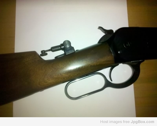

Hi crs. the 1895 is on my list for down the road, thats a beauty.. Right now its a companion for my two antique 86s. I have really thought long and hard on a 45-90 and I might end up there if I cant find any 50-100 or 50 alaskan dies, which I havnt been able to find.
Do have a few question for you. Hopefully not to many questions for you, thanks.
Did Browning and Winchester both have a modern 86 rifle made by Miroku?
Is that a Winchester Miroku in the pic?
What years were the Miroku rifles built?
Are the Miroku rifles set up to handle the case of the 50 like the model 71 .348
Do all the Miroku rifles come with the tang safety?
Are the Miroku rifles set up with two rear tang screws to accommodate a tang peep?
The only problem I have with the browning 71 is the pistol grip and the standard butt. I really want a straight grip, crescent butt rifle to start my project with just like in your pic.
thanks

Re: hi, newbie with 50-100 ?
Montana 22 asked:
Did Browning and Winchester both have a modern 86 rifle made by Miroku? YES
Is that a Winchester Miroku in the pic? YES
What years were the Miroku rifles built? MANY, but I do not remember.
Are the Miroku rifles set up to handle the case of the 50 like the model 71 .348 ? I have read that they can be had in .50-110, but I cannot personally confirm.
Do all the Miroku rifles come with the tang safety? YES for Winchester. Maybe not for Browning.

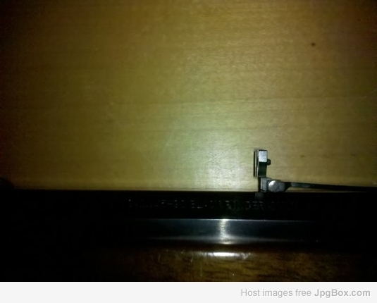

Are the Miroku rifles set up with two rear tang screws to accommodate a tang peep? NO for Winchester, but the Marbles peep tang on my 1886 does fasten securely with the one screw. Picture:
A bit of the front of the comb on my 1886 was removed to allow the elevated peep to fold fully back to lock position. The Marbles folding barrel sight makes a good combination with the peep.
I use the barrel sight for big game up close (ele, Cape buff, bison, etc) and the peep for more distant targets such as a Pronghorn (in Africa that was a tom leopard eating a farmers goat) .

crs. I have a marbles/lyman (cant remember) peep on my 45-90 along with the standard of the antique era barrel sights..Its really interesting shooting with all three sighting plains lined up together. I have mine sighted for 100yds thats about all my old eyes can handle.
I havent shot any open sight rifle so well as that 45-90 sighting system. Having those three sights set together its almost like the shooter cant aim un-correctly.
I really like that marbles folding rear site on your rifle. thanks for the great pics.
Browning 1895 bored out to 35 Whelen and shoot the old Barnes 300 grain bullet will kill about anything that bites.....Joe

This thread really strikes a cord with me. I have a New Haven stamped Miroku Winchester 1886 Takedown that was originally a 45-70. I personally dropped it off at Turnbull (they are only about 2hrs from where I live) and had them give it the full treatment along with reaming the chamber to 45-90WCF. I couldn't be happier with the result. With a 300gr JHP I'm getting Ruger #1 45-70 velocity at lower pressure. And it shoots lights out to boot.
Here is a back burner item on my wish list. I asked Doug Turnbull if it was possible to have a second takedown complete front half built for my rifle in 50-110WCF. I wasn't sure if an 86 set up internally for the 50s could also still run the 45s. He said it could be done without a problem. The idea of changing from 45-90 to 50-110 in seconds really gets me starry eyed! The only reason I didn't do it was my savings wasn't at the level needed for the cost of the second front half build along with everything else. I was quoted $5500 just for the front Takedown half (complete barrel, mag tube and forend). I'm not complaining or crying foul on that price, their work is second to none and well worth it. I just had to back burner the idea for a time and keep saving for it.
Secondly, at one time I hated the curved pistol grip, just for looks. Well, my 1886 was my first rifle with the curved pistol grip and not only have I come to prefer the looks of it over the straight grip, but it is much more comfortable to shoot. With straight grip lever rifles, I tend to leave my pinky finger out of the loop due to the way my shooting hand tends to grip the stock and put my index finger on the trigger. With the curved pistol grip, my natural grip places all three fingers comfortably inside the lever loop. It just seems to be a much more natural grip for me. I still like straight grips, but if there is a choice, I go for curved pistol grips now.

You have a beautiful lever gun there, and anything Turnbull is
Pretty much perfection. Although the take downs are very cool, you could get a 71 pistol grip or 86, if you want a straight stock, and do the conversion for about half that price. That being said, I could picture a 2 barrel cased set, and what a gorgeous set it would be.

I got the idea for the two barrel set from a GB listing I stumbled across awhile back. It was a vintage 1886 Takedown restored by Turnbull. The original front barrel set was 45-70 and Turnbull built a 50-110 second front barrel set. It was listed for $12g. That's what prompted me to confirm with them that an action worked to cycle and feed the 50s would also still cycle and feed the 45s. It was just the added cost of the second barrel set that was the barrier. Just didn't have it in my budget. Having one rifle that shoots the already formidable 45-90 as well as the 50-110 is the stuff dreams are made ofBearskinner wrote: ↑Sat Nov 05, 2022 7:53 am You have a beautiful lever gun there, and anything Turnbull is
