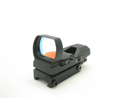

This is what I'm doing. I don't much care for the high postion of this propoint because of the rings but I'm building a stainless Puma in 454 for a feller and it will get the Hola type red dot pictured below.
But it will be in silver to match the gun. This thing is only about 3.5" long and the screen is about 1" wide. I'll probably end up cutting the rail down to fit it, too. That should make a more compact easier on the eye setup.

The barrel does have to be D&T-ed. You might be able to get a short rail mounted by D&T-ing a dovetail insert but I don't thing it would hold up to heavy recoilers by it's self.
That leaves the B Square side mount. I haven't used one but it's my understanding it too is a no gunsmithing mount. I haven't used one for two reasons. I don't like side mounted scopes and most non gunsmthing setups aren't very durable.
As for the reason for using that particular halo sight, mostly cost. I can sell that setup installed for less than $300.
How bout this? If you are concerned about D&T-ing the barrel then later removing the rail and replacing the stock rear sight, just D&T so the stock rear sight will cover the holes when replaced.

This Burris would be an even smaller alternative.
The screen is only .82" x .59"
