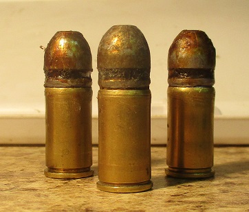

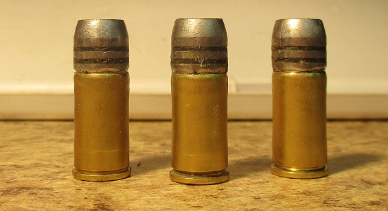

It takes a bit of time to cut the brass to the proper length, de-burr and chamfer it.
I loaded it with the new Killebrew bullet and the Huffaker bullet. Hope to get to the range this week if it dries out a bit.
The Killebrew bullet ... 12 gr. 2400
About 870 fps
The Huffaker bullet .. also with 12 gr. 2400
Around 820 - 830 fps
The Huffaker bullet is a hollow base bullet and records lower velocities than the same powder charge with a solid base bullet.
Hope to make it to the range this week. This last week was wet, windy and cold. Above 75 today so things should dry out nicely.

What do you suspect is the main reason for the velocity difference?
JimT
Posts: 6874
Re: Spent a couple days making brass for the 480 Achilles
Post by JimT »
Rimfire McNutjob wrote: Sun Jan 26, 2020 4:07 pm What do you suspect is the main reason for the velocity difference?
Extra capacity due to the hollow base in the Huffaker bullet. If I seated the solid base bullet out further (if I had room to do so) it would lower the velocity.

Those Killebrew bullets look as if they would do some serious damage to a living critter.
is that something like crimping in a gas check rebate?
