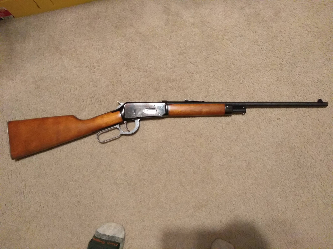

Hey guys,
I few weeks ago, with some help from you guys, I shortened the mag tube on this rifle and I really like the way it turned out.
I now would like to send it to JES for a rebore to 38-55. However, I'm a little worried that there isn't enough meat at the end of the barrel to bore it out. I'm wondering if anyone has had or heard of issues of a winchester 94 barrel ever being too thin to bore out.
The barrel seems fairly thin but in addition, the front sight is also dovetailed into it and right across from that is the fairly deep hole that received the mag end cap screw/pin.
The diameter of the barrel at the very end of the bore is .610", and the diameter about .9" back from there, at the mag pin hole is .620" . the diameter at the forend cap is .670.
I tried to measure the depth of that mag pin hole and do the math and it seemed like it was very close.
Let me know what you think.

The Win 94 BB 375 barrel measures .610 at the muzzle. So this shouldn't be a problem boring out to 38-55. It has a barrel band so it doesn't have the holes for the forend cap.

BenT wrote: Mon Jan 13, 2020 8:44 pm The Win 94 BB 375 barrel measures .610 at the muzzle. So this shouldn't be a problem boring out to 38-55. It has a barrel band so it doesn't have the holes for the forend cap.
That's good to know about the 94BB. I used to have one of those but sold it a couple years ago so I couldn't compare.
this gun actually does have a forend cap, and the forend cap screw goes through this guy that is dovetailed into the barrel

IIRC, that Jesse has to have at least .050" per side, at the muzzle, above groove dia. for a re-bore. So you need at least .475" or so, of muzzle diameter. I am sure he prefers more than that, but IIRC, that was the minimum. I would want at least .100" per side myself as at .050 and the gun falls and hits the muzzle, it would probably damage things.

Thunder50 wrote: Tue Jan 14, 2020 9:36 am IIRC, that Jesse has to have at least .050" per side, at the muzzle, above groove dia. for a re-bore. So you need at least .475" or so, of muzzle diameter. I am sure he prefers more than that, but IIRC, that was the minimum. I would want at least .100" per side myself as at .050 and the gun falls and hits the muzzle, it would probably damage things.
Thanks, I'll try to measure the depth of that mag screw hole again and re estimate how much barrel will be remaining. I'm not worried about the diameter of the barrel as much as the diameter of the barrel MINUS the various holes and dovetails which all seem fairly deep. I guess worst case scenario he would have to cut 1" off the end of the barrel and then re dovetail the front sight in?

The 375 barrel I have has front ramp sight not a dove tail, so that might be a better option. I beleive Jes can cut you dove tail for the forend cap.
