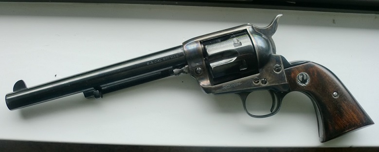

On a recent trip through Arizona I picked up a few guns that needed work. One of them was a nice looking .357 Armi San Marco that had a plugged barrel.
Looking down the muzzle ...
Looking in the breech...
It appeared someone had tried to pound the bullets out from the muzzle as the bullet in that end was flattened and deformed into the bore.
I pulled the barrel off the frame ..
Drilled a hole in the bullets as deep as I could and tried melting the cores out. Then I tried driving them out ... to no avail. They did not budge.
So I screwed a deck screw into the first bullet, locked the barrel down in a vise and pulled the bullet by hammering the deck screw...
Turned out there were 3 jacketed bullets in the bore ... the first two apparently heavy 35 caliber rifle bullets. The last one about the size of a 158 gr. bullet.
The barrel has a bulged area between 3/4" and 1" long. I have ordered a replacement barrel and that will be my next project.

Yep. If you are gonna run heavy rifle bullets you can't use Cowboy Action powder charges. The gun was cheap enough that I still won't have much in it when it's back together and I believe it will be a keeper!
Re: Plugged Bore
Someone must have been trying real hard to hurt themselves.
Re: Plugged Bore
I don't think so. I have shot heavy rifle bullets from the .357 with no problems. Silhouette shooters did for years also. I shot cast bullets which go down the bore easier than jacketed. And I wasn't trying to set any speed records. But you have to run them fast enough to clear the barrel. And you for sure don't want to fire another one or two up behind one stuck in the bore.
If the shooter had been running heavy loads the barrel would have had a large egg in the middle at least. Or maybe worse. Not just a swelled section. No .. I think these were light loads ... just too light to exit the barrel.
Re: Plugged Bore
I was sort of thinking the along the same lines.
Maybe the reloader's logic went something like "If I load them extra light there will be less recoil and then I can crank off 4 or 5 real fast".

I pushed a few lubed bullets through the bore to check. It is tight at the muzzle ..an inch or so down the bullet will drop through for about an inch .. then it is tight at breech. It may shoot OK .. I have seen barrels that were "egg shaped" in the middle and they shot fine ... BUT like you said I don't like it being there. I have a 7 1/2" barrel coming and will see what I can do with that.Sixgun wrote: ↑Thu Apr 04, 2019 11:15 pm

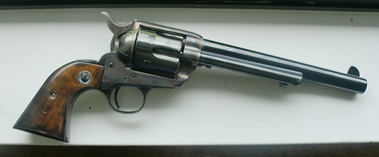

I have the new barrel installed ... I also put a set of old Ruger XR3 grips on it. Fired a few shots in shop to make sure it's working. Will take it to the range when the weather permits.

What did you set the gap space to? I am not any sort of gunsmith, so I am curious.
Re: Plugged Bore
It was the weirdest thing. I haven't changed all that many barrels in my life but I have never had one that fit right out of the box. This one screwed in and tightened up with just a little file work ... the ejector rod housing lined up perfectly ... and the barrel/cylinder gap is .008" which is within tolerances. If I was fitting it I would like .005" but this works and I am gonna shoot it for awhile and see how it does. If it works OK I ain't "fixing" it an further.What did you set the gap space to? I am not any sort of gunsmith, so I am curious.
