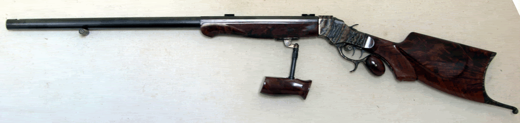

I have a CPA (Stevens 44 1/2) Schuetzen Rifle on order. Probably will not see it until Oct. or Nov. It will have 38-55 and 22RF barrels. I will have to say that this is most expensive firearm that I have ever purchased, and it is lever operated.

Ken41 wrote:I have a CPA (Stevens 44 1/2) Schuetzen Rifle on order. Probably will not see it until Oct. or Nov. It will have 38-55 and 22RF barrels. I will have to say that this is most expensive firearm that I have ever purchased, and it is lever operated.
Ken41,
Those are beautiful rifles. I was looking at one on Gunbroker with envy, wishing I had the cash. It would have been over $6000 new, and never sold at $4200: http://gunbroker.com/Auction/ViewItem.asp?Item=98030049
I'm sure you'll enjoy yours. Be sure to post pics when you get it. I have a Ballard Pacific and a Hepburn, both in 38-55, that I will someday restore and start shooting in Schuetzen matches.
