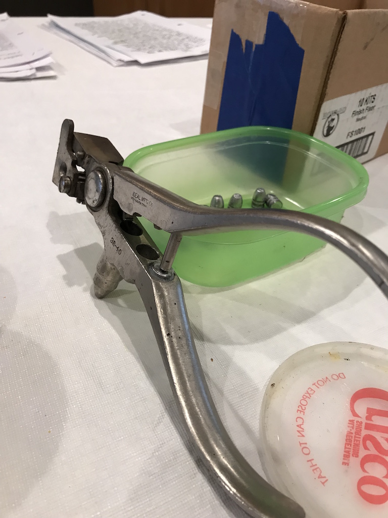

I cast about a hundred bullets and just wore a leather work glove on my left hand. It was good enough.
The mold blocks don't fully meet so many of the bullets have some flashing on them that will be cleaned up when being sized, or if necessary with a fine cut file. They are dropping from the mold at about 0.412 cast from 20:1 alloy. The Ideal tool sizes them to about 0.401.
Some of the sized and unsized bullets. I'm lubing this batch with Crisco to shoot on top of 3Fg Swiss.
How you size them with the Ideal tool:
You really get a workout sizing bullets like this. A Lee .401 sizing die is on the way for use in my press.
