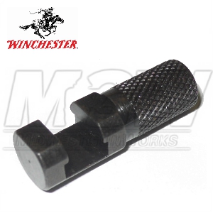

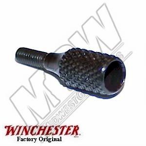

Re: model 94 big.bore 444 with wood stock.and cross bolt safety and full magazine
If your BB94 has a threaded hole in the upper portion of the hammer, it will take Winchester's stud-type hammer extension - which can be installed on either side of the hammer, whichever is more comfortable.
If there's no hole, one like this has worked for me, with a tad of filework/fitting.
