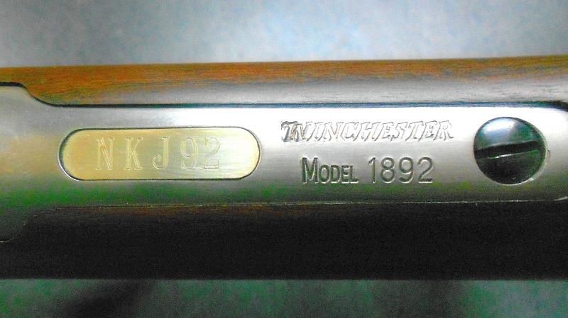

Buy it if the price is right then convert all the rebounding hammer, inertia firing pin, tang safety junk to traditional 1/4 cock hammer, full length firing pin, fire control parts.
Now you got the best of both worlds. modern steel with traditional fire control action.
This one also got the tang safety welded up then color-cased.
This one because it was coin finished got plugged.
