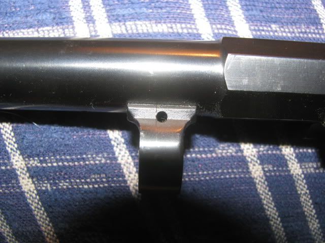

FWIW - Magazine tubes, running through a barrel hanger, are usually pinned at the hanger, where the pin would have one half it's diameter intersecting a groove in the tube & the other half in the upper section of the solid hanger.
The small pin would needs be removed prior to removing the tube & then the forend.

Here's a pic of the hanger showing the hole for the pin:Pete44ru wrote:FWIW - Magazine tubes, running through a barrel hanger, are usually pinned at the hanger, where the pin would have one half it's diameter interseceting a groove in the tube & the other half in the upper section of the solid hanger.

Thanks!
I will see what I can do to remove it.
