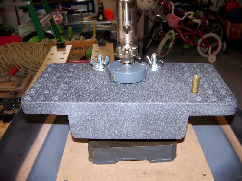

I have a Lee case trimmer for almost every caliber I own. Works fine, and they are very inexpensive. Now, if you are going to trim a lot of cases, the Lee would get pretty tiring. I picked up a Lyman hand-crank model that will handle pretty much any and all cases, and allows you to adjust the trim cut. Later I added the drill adapter so I don't even have to crank it. Then I purchased a Lyman "universal trimmer" from cubrock here on the forum. It is for use with a drill press. Here is a picture of it:
I purchased this one for trimming down .45-70 Government cases to .45-60 WCF specs. Built a base for it to slide onto my drill press:
So... it really depends on how much you think you'll use it (the case trimmers), how much you need to remove, and how many calibers you need to trim for.
