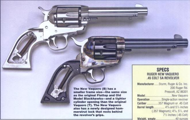

BHB beat me to it. I'd bet a box of primers those front sights have been filled down.
Compare them to the sights on these two Vaqueros. It doesn't take much to affect the point of impact.
