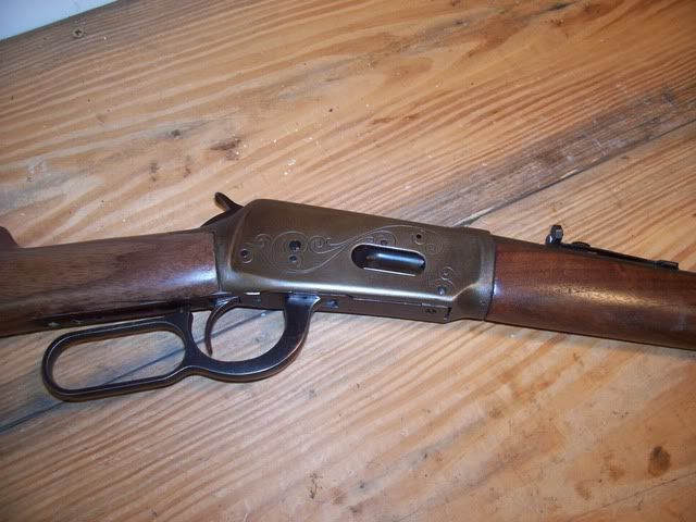

I had a similar vintage receiver that I used in one of my puzzle projects. There was no flaking, but there was no finish left on it either. I buffed it down and browned it. I didn't strip what bluing was on the rest of the components and just browed over it.
The gun came out with what looked like a well earned patina on an old gun that had seen honest use.
This is what I started with.

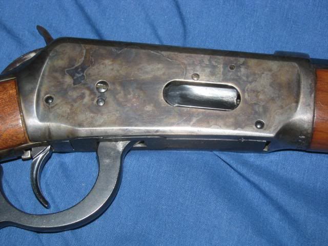

The iron clad receivers will take a good CCH treatment. This is my 1979:

That looks great. Where did you have that done?Griff wrote:The iron clad receivers will take a good CCH treatment. This is my 1979:
- Posts: 21548
Re: what can be done with reciever flaking on post 64 Win 94
It was done back in 1989 by a fellar in Wyoming, since retired. It's a true bone & charcoal CCH. He used a steel block inside the reciever to keep it straight and true... I had the lower tang and forend cap done to match, but didn't think about the buttplate or the lever at the time... I wanted some contrast with a regular blue. None of the metal was highly polished, just to about 1,000 grit. The barrel is pretty flat, but there are no reflections, even in bright sunlight. That photo wasn't very sharp, here's a couple that're better.Model 52B wrote:That looks great. Where did you have that done?Griff wrote:The iron clad receivers will take a good CCH treatment. This is my 1979:
