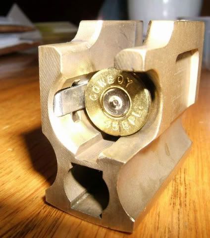

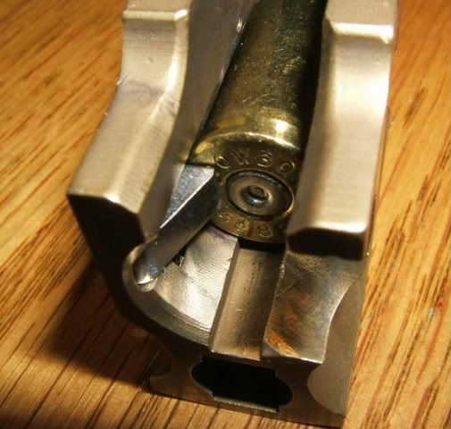

What he didn't know is that there's a new "Short Stop" carrier in pre-production prototyping right now that will solve the conundrum of running short rounds like .44 Russian and Cowboy .45 Special in the '60, '66 and '73 rifles. Designed by me (Adirondack Jack of cowboy45special.com) and engineered by Bill English of The Smith Shop, the notion that the "cartridge stop" is the loading gate (a poor idea, as any 66 owner who has broken off a loading gate ladle will tell you) has been worked around, by the addidion of a positive, pivoting mechanical stop that actually is engaged and held fast by the pressure exerted on the rounds by the magazine tube spring, and as soon as the carrier lifts, "floats" with only a light music wire return spring in tow.

adirondakjack
- Posts: 1925
- Location: Upstate NY
Howdy Steve,Nate Kiowa Jones wrote:The 66 and 73 has a built in ammo gage. Open the action, turn the gun over and lay a round in the window where the carrier rides up and down. If it doesn't fit, it's too long. It should be about 1/16 but not more than 1/8th inch short of not fitting. This length works best because the 73, 66, and 60 does not have a mag cartridge stop. The front edge of the loading gate is the only stop. The carrier is the stop while it's in the up position.
The carrier with an integral mechanical stop is on the way. The first batch will be with us in a few weeks.
Waddaya think?

Hi AJ,
Nice looking work. Just looking at it it appears it will only run the shorter stuff correct? To run standard length ammo you would have to change back to the original, right?

The frame in the back of the carrier cutout extends down far enough to stop it.Ben_Rumson wrote:adirondakjack... That's a neat modification..But I'm curious to know what do the Henrys use for a cartridge stop what with no loading gate? Anyone? Is it just the rear of the lifter?

adirondakjack
- Posts: 1925
Howdy Nate, Thanks for the kind words.Nate Kiowa Jones wrote:Hi AJ,
yes, to revert to normal length ammo, the carrier gets swapped back in. That's just about the same level of retrofit required with the Spur Shortstroked Marlin that I run. If I wanna go shoot a deer, I swap the .45 Colt carrier back in....
FWIW a few of these carriers will be made using the '60 henry carrier blocks, so the folks that want to experience their Henry with a CF cartridge very close to the old Henry Flat can do so using the Cowboy .45 Special.
They'll be essentially the same as the '66/73 carrier, but with the correct bottom profile for the Henry receiver.
I ought to have a couple pre-production samples next week to use for "show and tell" and final testing before we go ahead with the production run. I'm anxious to try one, as we've really been trying to make this a mod that will be transparent to the shooter (no palpable change with the mechanism in there) which is not something that's been seen with earlier attempts using a brute force stop. Hap assures me he can't feel it when he operates the lever. That's gonna be MY acid test, along with the 100% positive operation which he's got nailed with this redition of my design.
