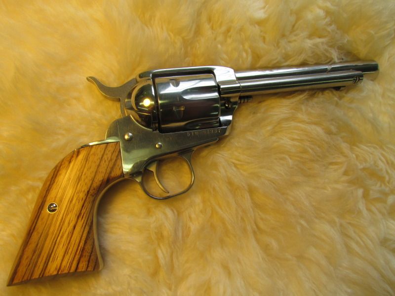

I posted a pic of my little duplicator a couple weeks ago.
Well I finally got the first set done.
I have two more sets almost ready for finish now.
These are of Zebra wood from Africa.
A fairly soft wood but different. :D
Poor pictures due to much glare. I need a soft white bulb instead of that thing compact florescent. :x

Looking good Chuck. What finish did You put on them and could they be made darker ?

pwl44m, I used True oil. Five coats but they needed to have more coats to completely fill the pores.I was kinda in a rush
to get to the next set. :oops:
They could be stained or died to make them darker.
If I want darker I usually choose darker wood to begin with.
Thanks for the compliments guys.
I think these would really stand out on a blued gun.
More to come. :wink:

pwl44m ,Perry, Your comment got me to thinking ( not allays a good thing for me, it causes lots more work quite often) :shock:
I took the next two sets I have been making out of that Zebra wood and gave them a coat of Herter`s French Red stain.
They are coming out real nice ,almost the color Winchester used on early levers. They still have the cool stripes very pronounced with some honey colored cast in some areas.
I will post some pics in a few days.
They will get at least 10 coats of True Oil and a good rubbing.
:wink: That takes some time to do.
