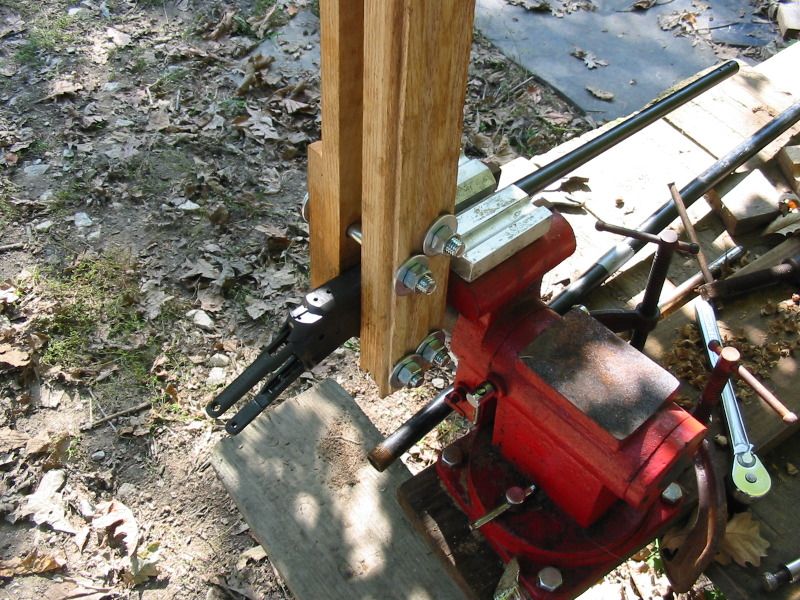

Well, I did it...
Tried several 'jaws' for the barrel, including a 1/8" thick wrap of lead, clamped inside two pieces of pipe 1" inside diameter inside oak blocks, etc., but the aluminum AR-15 barrel clamps got the job done even though I think they are for 3/4" barrels and the Marlin was 15/16"; the four points of contact did well. Old oak floorboards and 1/2" bolts clamped the receiver.
The only casualty was although I knew to keep the bolt in the receiver so the action wouldn't distort with the heavy clamping pressure, AND I even knew to keep the bolt back a bit so the barrel didn't hit the bolt-face, I didn't realize how far the extractor sticks out, and didn't remove it.
So...
New extractor (I had one in my spare-parts inventory, but need to replace it) = $15
Savings from not paying local gunsmith to do removal $45 and install $45 = -90
So I figure out I'm "ahead" $75...

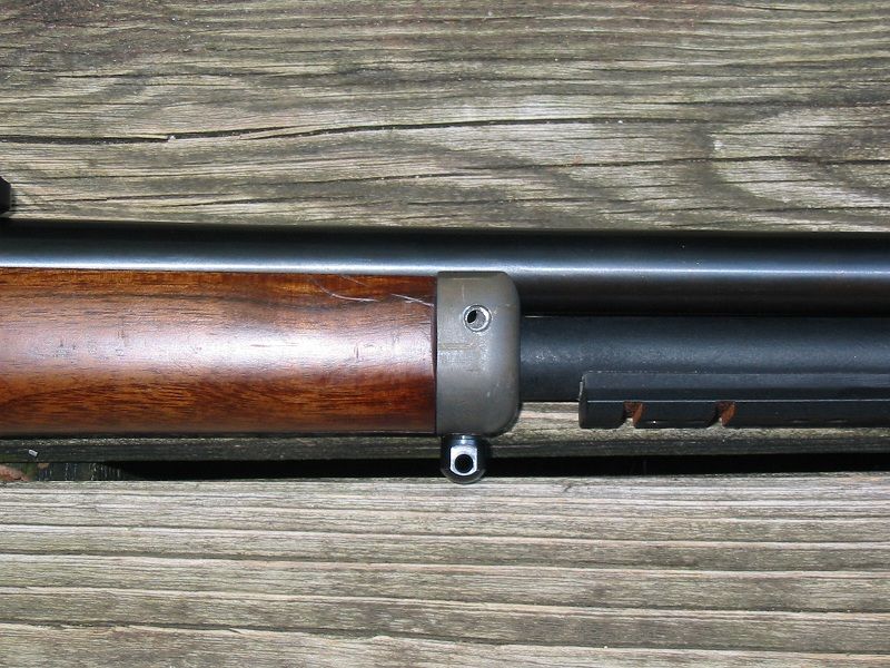

The finished gun has a parkerized receiver, blued barrel, and CeramaCoated (Wheeler) magazine tube, an original walnut stock with the forend slimmed by a good local gunsmith years ago. Unfortunately, there IS a subtle difference in where the forend hanger dovetail is, as you can see. Not sure what I'm gonna do about that at the moment. Probably get a new forend, I guess...
So...

AJMD429 , take a close look at that fore end cap hanger, you may be able to reverse it it the threaded holes are not exactly centered in the dovetail slot.
How about just making a new one (fairly simple part) and use your end cap as a guide to drill and tap it for the screws. Or buy one and weld up the screw holes and re drill and tap???
Nice looking job, Congrats!

The really HARD part was getting the barrel clamped.

I suspect I could grab some bolts and a couple chunks of wood to do what you did. Matter of fact I was thinking along that line, but have been otherwise occupied.
I have that barrel vise I got from MM Wright, all I need to do is bolt it to my work bench.
Maybe I should try to do that barrel swap. Who knows I might succeed.

For me, the hardest part was just getting up the 'nerve' to start. I'd heard horror stories of bent receivers, broken wrenches, and so on, and didn't want to scratch my old barrel to pieces, much less the new one.J Miller wrote:Maybe I should try to do that barrel swap. Who knows I might succeed.
It turned out much easier than I'd thought, overall.
I just have to re-hang the forearm now.

Re: Converting Marlin 1894 from 44 Mag to 45 Colt...?
Since your hanger holes are aft of the cap holes, you just need to remove some of the wood on the forend. A FLAT rasp should have cutting surfaces on the edges as well as the normally thought of cutting surface. If you rasp normally, around that "lip" on the end of the forend you would remove wood that should be left in place to keep the forend tight. However, what I did, was to take one edge of the rasp and remove that cutting surface, so it would only remove wood on the one plane, as my new forend was a tad long, and the old one was far too short. Pictures will have to wait till I get back to my truck.
- Posts: 4296
- Location: Vinita, I.T.
AJMD429,
Looks to me like all you gotta do is take a little wood off to let the fore-end cap come back to where the screws will go in. Anyway, congrats on getting it done. Always a lot satisfaction in doing it yourself.
