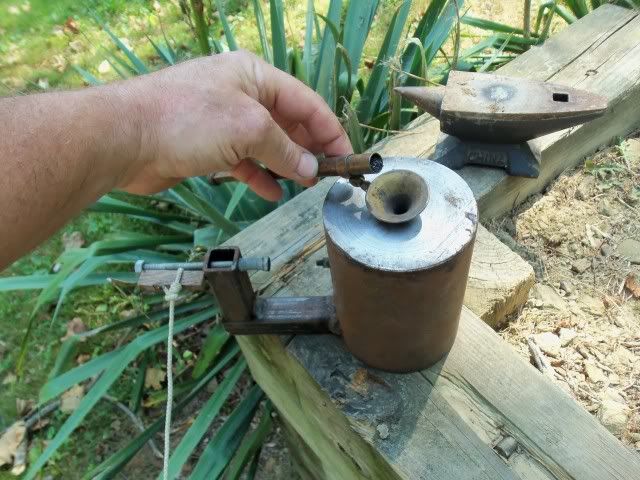

Back in the days of old in America, the fourth of July was a welcome holiday where many small towns had some sort of festival that on many accounts had fireworks. There were also many towns that due to lacation, funding, lack of planning or what ever, didn't have fireworks so other ways were used to get the desired boom and thrill of black powder being burnt or dynamite exploding. There was an old method of using two anvils to get an explosion. It's called anvil shooting. Many anvils have a concavity in the base and when that anvil is placed on the ground upside down, the cavity can be filled with black powder and another anvil is placed on top of the first, right side up. Thus the powder is captured between the two and when lit, explodes with much noise and smoke and the top anvil flies up into the air some many feet. Yeehaw. Well over the past few years there has been a rebirth of anvil shooting with organized events and competitions. The current record is over 500 feet for a 100 pownd anvil. Amazing. The only problem I see with all this is cost. The big boys are using up to one pound of powder at a time and at some $20 per shot, I'm out. So I started the quest to make the sport more frugal and came up with mini anvil shooting. That's right folks, you heard it here first. I have decided on a max load of 100 gains of black powder, a common hunting load for a muzzle loader, and percusion caps as the ignition source. in the pictures you will see the equipment needed. I have a bore for the powder that is 1/2" by about 2 1/2" deep. I just kept drilling untill a 100 grain measrue filled it. I put a card cut from a beer case to protect the anvils from fire etching and then place the anvil centered over the hole. The pecusion cap is placed on the nipple last. There is another block in the picture that was a tester. It has a 25 and 70 grain hole and is fuse lit. I found that the fuses started to get expensive quick and that lead to the cap system.
Happy Fourth Of July, America, Gobbler style. :wink:
Here's a video. I couldn't load it like you do pitchy. I can't figure it out.
Gobbler
http://s24.photobucket.com/albums/c3/go ... 0_0434.mp4
Here's another but I can't turn it. You have to turn your computer. :lol:
http://s24.photobucket.com/albums/c3/go ... 0_0435.mp4

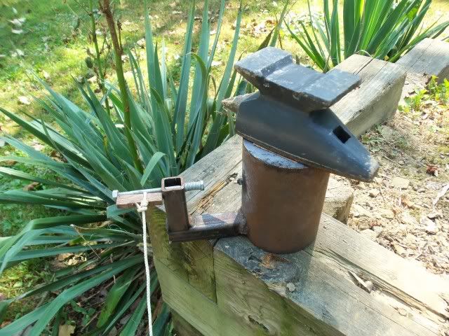

And now what I think is the best combination. 1lb anvil with 100 grains of black powder.
http://s24.photobucket.com/albums/c3/go ... 0_0437.mp4

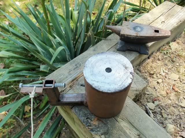

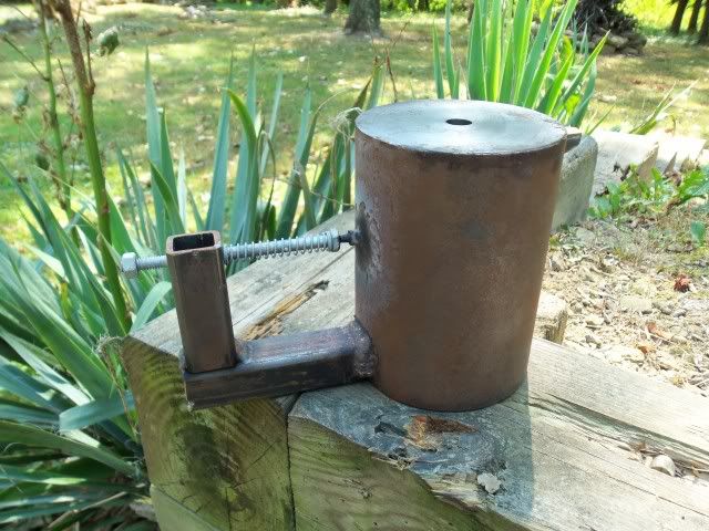

I tried a half dozen firing methods and this was the best. If you look real close in the one picture you can see a little hole in the firing pin. All of the pin in the grenade style that I tried took too much pull to get the pin to come out without moving the shooting base. This method proved to be very resistant to accidental bump and without the cap, is unarmed anyway.The cap going on is the last step. I like this better than the fuse in that the shooter has all the time in the world to prepare and fire when ready. Not wait for it, wait for it, waiBOOM......

Gobblerforge wrote:I tried a half dozen firing methods and this was the best. If you look real close in the one picture you can see a little hole in the firing pin. All of the pin in the grenade style that I tried took too much pull to get the pin to come out without moving the shooting base. This method proved to be very resistant to accidental bump and without the cap, is unarmed anyway.The cap going on is the last step. I like this better than the fuse in that the shooter has all the time in the world to prepare and fire when ready. Not wait for it, wait for it, waiBOOM......
Glad to hear it. Still looks more scary than I'd want to risk while placing the cap & walking away... :oops:
Ever thought about using a 1/2 round section of PVC pipe instead so that it has a little more "keep it from just falling off" wrap across the top of the firing pin? Such a rig should still pull off as easily as the block of wood...

Good idea and worth trying. Hey, I'm just the concept, design and production manager. Detailing is down the hall. :lol:

Maybe a fender-washer under the head of that bolt would keep my heart rate from red-lining while placing the percussion cap...

I can't give a thumbs up to that ignition system either. How about polishing the pin, the hole, and whatever metal it rubs against (and minimize that too) with a dremel and some polishing compound. I'd bet you'll lower the pull needed by a huge margin while going back to a much safer ignition system.

Gobbler, another thought: How about just using the already drilled hole as a "safety"?
Put second rope on a loose but full-through cotter pin that does not bind when the spring pressure is on the wood block.
After priming the detonator, first pull out the cotter-pin safety, then release the wood block trigger.
Beats losing a Face....

I gotta say that since I put a lot of time into trying different trigger devices and found one that never failed, I am stunned at the folks that have never tried it, yet discount it. Is this the direction my America is heading? More folks picking on a simple trigger that works than paying attention to the actual event done for your enjoyment. I feel I've failed at trying to share what I enjoy.

I reread my post and I did come across irritated. Sorry about that. It's just that after a lifetime of black powder experience, and having strict safety rules, it's kind of insulting when folks immediatly assume I have no idea what I'm doing but are certain they know all about it. I have been working on this project for about six months and a half tin of percusion caps to get the results I want, good safe boom and inexpensive. I wanted to share the fun. The dangers are no more than hunting with a muzzle loader and perhaps less. My opinion, of course. :wink: One discarded method would have included using an old single shot action I have to be mounted in such a way the when the hammer fell it would stike the cap. I wish I would have taken a picture of the mockup. I still chuckle at how silly it looked. Very overcomplicated and I felt bad cause it can still be made into a working gun/ furure project.
Even the lightest load of 25 grains did a good jub of sending the 1lb anvil some 20+ feet and a good boom. Go on youtube and look at all the videos of full size anvil shooting. Lots of fun there.

Gobblerforge wrote:I gotta say that since I put a lot of time into trying different trigger devices and found one that never failed, I am stunned at the folks that have never tried it, yet discount it. Is this the direction my America is heading? More folks picking on a simple trigger that works than paying attention to the actual event done for your enjoyment. I feel I've failed at trying to share what I enjoy.
If you are going to get in the spirit of it, why have a trigger system at all? Just a line of gunpowder or a short fuse and run like heck.
Gobblerforge
Posts: 1528
Re: Shooting anvils for Independence Day
Post by Gobblerforge »
I could see a powder line working but the reason for the percusion cap was to eliminate "running like heck" with the fuse. The cap remains idle until the shooter is ready, no matter how long. Then there is the cost factor. If you shoot enough you will find that fuse gets expensive. The caps are inexpensive in comparison and more available. I have been shooting enough now to be able to land within 10' of my intended target, usually a pop can. :wink:
Gobbler
Click Click Boom
