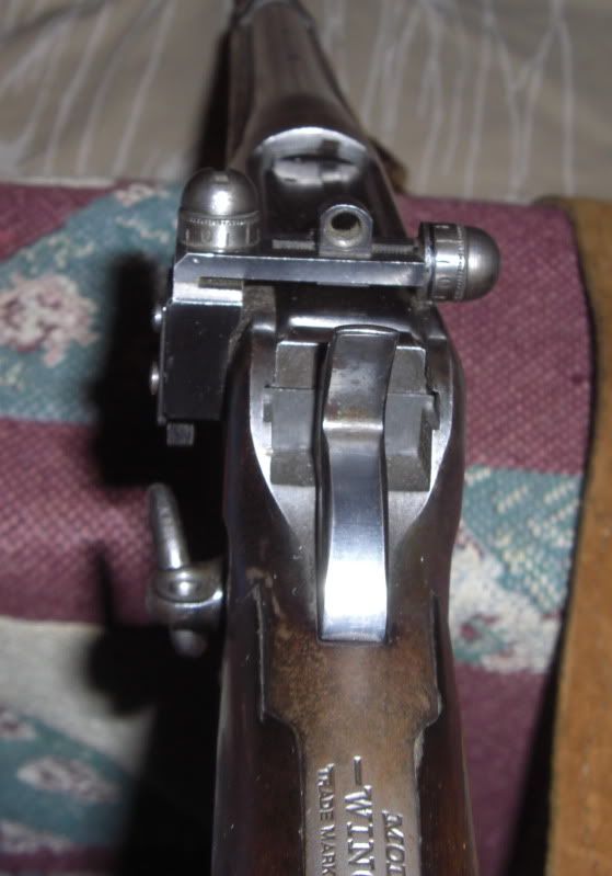

The Redfield 70 "D" is the correct sight for the '95 Winchester. My 1924 original has one, but it is the earlier 102 "D". :)
IMG]http://i2.photobucket.com/albums/y24/ol ... ield95.jpg[/IMG]

The Redfield 70 "D" is the correct sight for the '95 Winchester. My 1924 original has one, but it is the earlier 102 "D". :) Oops, the photo didn't translate on the first reply :oops:

Thanks Mike. It's good to hear from someone with an original.
On mine, with the elevation wound all the way down, the base of the windage adjuster hits the receiver just to the right of the bolt. This leaves approximately "1/8 between the top of the bolt and the bottom off the sight arm. Is this the case with yours?

Affirmative. I believe that they all contact the right side when down to "0". I have a couple of Lyman 56s for the '95, but since the old Redfield came with the little .30-06 it will remain in place. This is exactly where the sight stays while hunting, so there is no issue with shooting whatsoever. This carbine has taken a number of deer over the years and goes on every trip.:)
