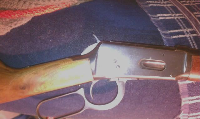

Re: Recoil pad for win 94
i'm not sure if a post 64 stock will bolt right on, or
not but i'm sure it can be made to work for temporary.
as you can see, this on is shortened and has a recoil pad
installed. as is about 1 1/2" less than a stock, stock.
let me know.
let me know.
"BECAUSE I CAN"
"BECAUSE I CAN"
That stock looks great Pokey, thanks!
