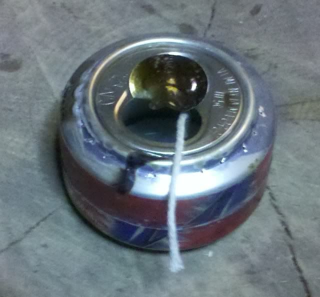

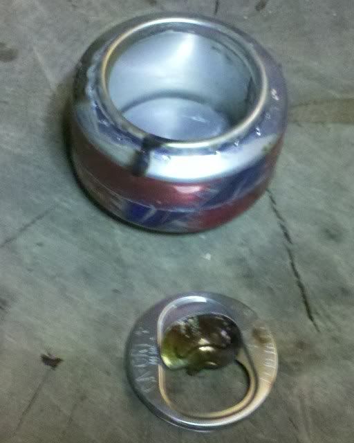

Imade one from pop cans with smaller holes, maybe to small, used a needle and burning Isoprohple( sp)
- Posts: 1925
- Location: Upstate NY
Re: My---"Because I Can"---Oil Candle...
Pitchy wrote:Imade one from pop cans with smaller holes, maybe to small, used a needle and burning Isoprohple( sp)
Though I haven't tried it, they say iso ain't that great. Get yer hands on some denatured or 190 moonshine, and a-waaaay ya go......
If need be, a push pin, which has a tapered point, can be used to ream the holes out a little.
Certified gun nut
Yepper reamed out the holes with a needle but still doesn`t work very well the flame gets high but yellow. Maybe it`s the fuel like ya said, i don`t have any heat or alcohol right now.
How about Coleman fuel ?
Thats pure unleaded no additive gasoline Pitchy...Pitchy wrote:Yepper reamed out the holes with a needle but still doesn`t work very well the flame gets high but yellow. Maybe it`s the fuel like ya said, i don`t have any heat or alcohol right now.
Yep tried some burt terrible, no wonder my lawn mower hardly runs.
I`ll pic up some heat tomorrow, tanks.
Success, got some heat, works good.
Never give up, Because I Can.

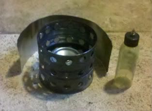

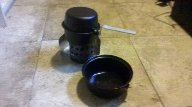

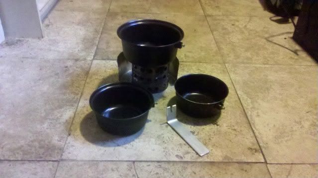

To get this all on the same thread, here's the camp kitchen meant for kayak camping all fleshed out.
Cheap pots from the dollar store, the plastic handles removed, the handle mounting screws shimmed with small hex nuts under the nose of the screw and snugged, leaving them as studs to hook the new handle on in use. One small pot has the rim removed to make a fitted lid for the other small pot. This rimless pot would double as a bowl. The handle is 1X1/8" aluminum stock, and fits all of them.
A covered pot boils faster... Note, the handle simply slips over the screw head and gravity does the rest. No need to secure the handle. The handle would be removed while the pot is on ths stove, so
it stays cool.
Nested, ready to stuff in a drawstring bag (once I find one. I have several somewhere). The biggest (3 pint) pot is 6.5" wide.
Materials list for the entire project.
Stove:
Two 12 oz soda cans.
one #10 tee nut, the barbs removed
one #10 round head brass screw, maybe 1/2" long (the tee nut and screw are the filler)
1" x about 10" strip of aluminum flashing as a band around the middle of the stove.
JB Weld to assemble.
If ya wanna make life easier, buy a small number drill, on the order of a # 73 or #74 to drill out the jets. A push pin can work, but it's tricky to get em equal and the correct size as ya only push it in partway onto the tapered point. A GOOD hardware or machine shop will have small drill bits individually, probably cost ya fifty cents.
Pot stand/windscreen
One 1 lb coffee can, the middle cut away and the two ends interference fit together to achieve proper height.
Windscreen is aluminum roof flashing, maybe 3.5 X 10"
Pots:
two 2 pint pots and one 3 pint pot, $1 each at dollar store.
Handle, 1X1/8" x 6" aluminum stock.
Fuel bottle:
two ounce travel size bottle of shampoo, mouthwash, etc from walmart, ($1 or so, dump out contents)
one small "through tank" type brass hose barb and nut for the spout (in the small tubing fittings stuff at a farm supply or hobby shop) , and some bit of silicone tubing and a plug of some sort as a spout cap. (or find a bottle with a small spout to fit your filler)
Alternately, use "HEET" fuel additive for fuel (comes in a nifty 4 oz bottle), and use a small funnel to get it in the stove.
The only things I bought directly for this project were the pots, ($3) as I used whatever I had for the rest. If purposely sourced, the JB Weld would be the most costly at $5, and the rest could be done for probably $10 total, including a brass screw and matching hex nut ( a tee nut isn't really needed, but that's what I had), and a small sheet of aluminum flashing type stock and a handle of heavy aluminum wire instead of flat stuck, all from LOWES or Ace Hardware....
IMHO it beats $50-$100+ for commercial backpacking stuff, especially since ya made it yerself
it stays cool.
Stove:
Pots:
Fuel bottle:

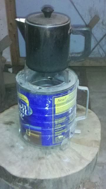

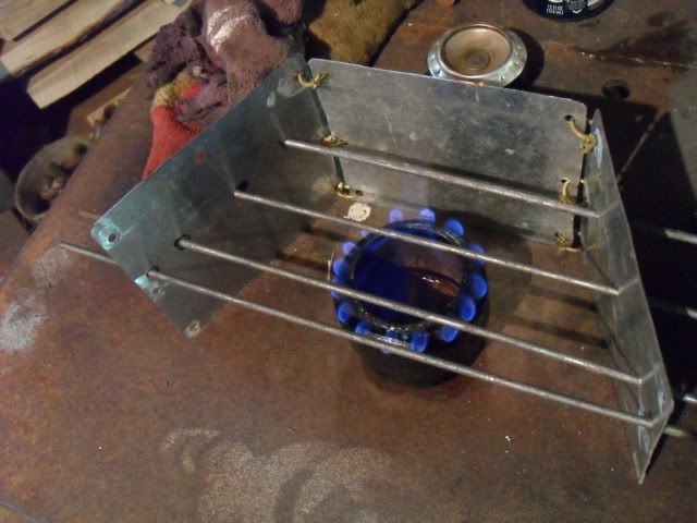

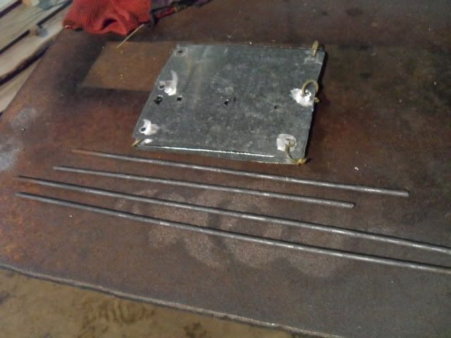

Before i read these replies i went out made this, folds up for easy carry but have the open top issue.

Re: My-"Because I Can"-Oil Candle & Alcohol Stove's
Nice one Pitchy
Heck that one's heavy duty enough to handle a cast Dutch Oven

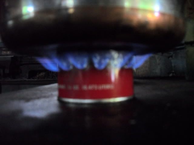

I`m starting a new one that`s a little different. It`s kinda modeled after the one i ordered but haven`t got yet.
It`s made by cutting the top out of a can and inserting it up side down in the lower part of the can, then drilling holes around the sides. I`ll post a picture of it burning later as the JB weld id drying now.
Cranked it up, nice design and works very well.
- Posts: 1925
Pitchy wrote:Cranked it up, nice design and works very well.
Wow Pitchy boiled his lathe and it shrunk

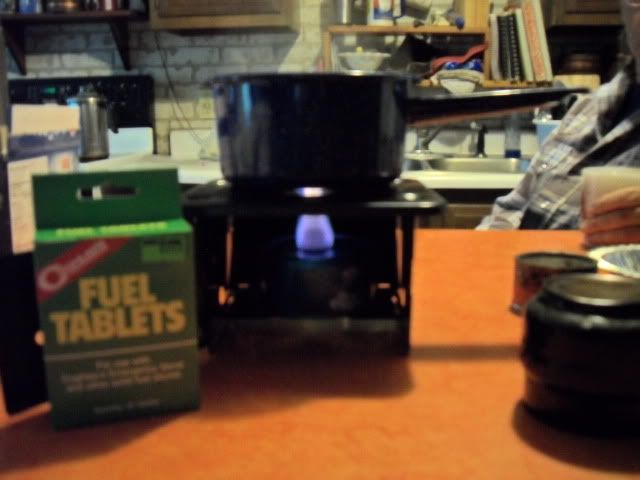

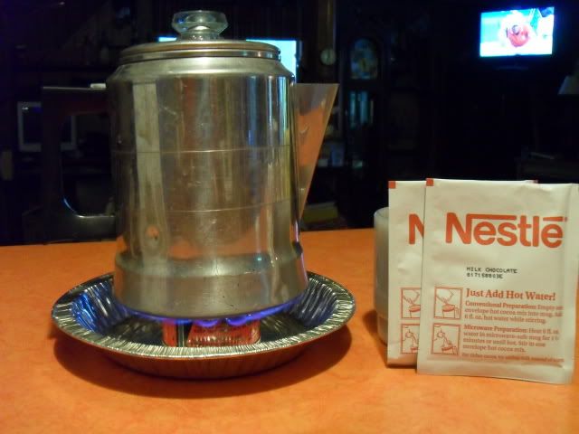

Picked up this colapsable stove today and tried some of the fire pellets which work nice and burn 9 minutes.
All me stoves work in this folding stove.
Griz have you ever expermited with catilous from mufflers, if ya run a gas vapor through it it burns very hot.

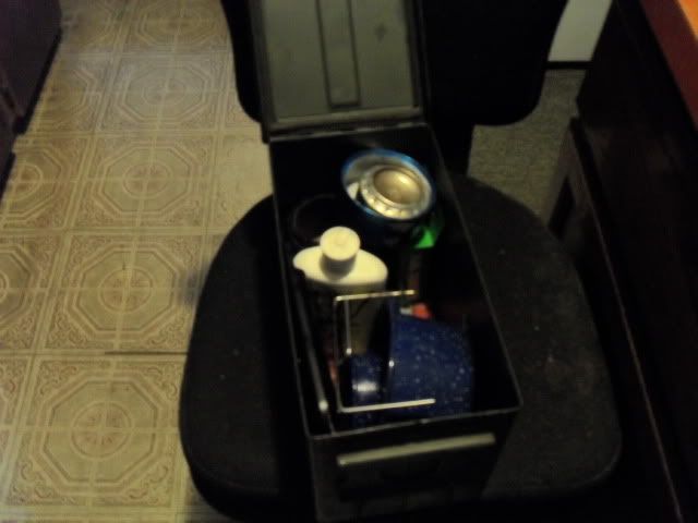

Everything fits in a ammo can pretty nice.

The stove burns long and slow, simmering a pint of water for a good ten minutes on an ounce of denatured alcohol, when the pot is placed 1" above the stove.
I think the drill will be to use the pressurized stove to boil water NOW, or to get a frying pan HOT, then switch to the slower open top stove, with or without the simmer adapter to finish the job if it entails more than JUST bringing water to a boil. The weight/space penalty is minimal.....
A small pair of hemostats or needlenose (which I happen to have in my fishing bag) make tending these stoves easier. Adding the simmer adapter when the stove is lit, reaching through the holes in the pot stand to light the stove with a burning string, etc.....
24 jets drilled with a .0260 (#71) drill, angled nearly straight up. The piece in the foreground is cut from a can top, sized to fit in the open top stove as a simmer adapter.
Like this. The (consumable) string makes lighting easier, helps keep the stove lit when first starting with the simmer adapter, and makes life easier on the fingers when using a lighter instead of matches to light the stove.
Last edited by adirondakjack on Mon Jun 13, 2011 7:32 pm, edited 2 times in total.
Certified gun nut
Not so fast, Pitchy.......Pitchy wrote:Everything fits in a ammo can pretty nice.......
You still need a "woodgas" stove made from a quart paint can and one Progresso soup can.
Then, you can burn litle handfuls of wood or drop your alchol stove inside it when you don't have time to find wood bits.
I went to use my casting bench the other day and found that I had piled all my stove experiments and make-shift cookware onto it.
So, I started clearing off the casting bench and four hours later I had two new stoves made and and tested out and a couple new lids for my fruit can Billies.
Never even fired up the lead pot.

Did somebody say "wood gas"?
Did that a few years ago, even built a giant sized wood gassification stove to heat my shop (but replaced it with a masonary heater).
I did keep this little guy though:
3lb coffee can with a 1lb coffee can inner, adjustable bottom draft, etc. We used it in 10 degree weather with wood chips and charcoal to make coffee and warm hands while deer hunting.
Kinda bulky for kayak camping, but it does work.....
Certified gun nut

http://www.backpacking.net/makegear/fal ... index.html
my solid fuel stove is bigger and heavier and ported differently, and stainless steel, but other than that it's just like this one:
I have another shot of that muffler tube that I am going to shorten and make a lot more like this one. They do burn hot. You can get them to gassify with an inner can and some jet style holes, but, why bother? Just that much more to go wrong!!

Just as a test, I made coffee with the open, low pressure stove just now. Started with about 14 ounces of water in the covered pot, 3/4 ounces of alcohol in the stove. As the water got hot, I tossed in a "coffee bag" made up of folded coffee filter with very fine ground coffee, stapled shut, and let it run until the fire went out (just about 10 minutes, without using the simmer adapter.) Then I swished the coffee "bag" around a bit, and poured the coffee into a cup, leaving the "bag" behind. A very good cup of coffee in exactly ten minutes. Sure does beat the heck out of making enough of a wood fire to make coffee..... This is gonna be great when fishing from the kayak. A cool evening on the lake, pull into a cove, get out to stretch my legs, and in 10 minutes, hot coffee.
Certified gun nut
Nothin like a fresh cup of joe and a hand warmup all at the same timeadirondakjack wrote:Just as a test, I made coffee with the open, low pressure stove just now. Started with about 14 ounces of water in the covered pot, 3/4 ounces of alcohol in the stove. As the water got hot, I tossed in a "coffee bag" made up of folded coffee filter with very fine ground coffee, stapled shut, and let it run until the fire went out (just about 10 minutes, without using the simmer adapter.) Then I swished the coffee "bag" around a bit, and poured the coffee into a cup, leaving the "bag" behind. A very good cup of coffee in exactly ten minutes. Sure does beat the heck out of making enough of a wood fire to make coffee..... This is gonna be great when fishing from the kayak. A cool evening on the lake, pull into a cove, get out to stretch my legs, and in 10 minutes, hot coffee.

My best luck with alcohol stoves to date is the plain old cat food can stove.
For smaller pots, like a GSI mug or Esbit mug, I made one using a slip-top tin that is 1.5" high and 1.5" wide. It barely holds a tablespoon of alcohol but will boil 12 ounces of water in about 6 minutes and hold the boil for another thre or four.
Stupid-simple stove.
